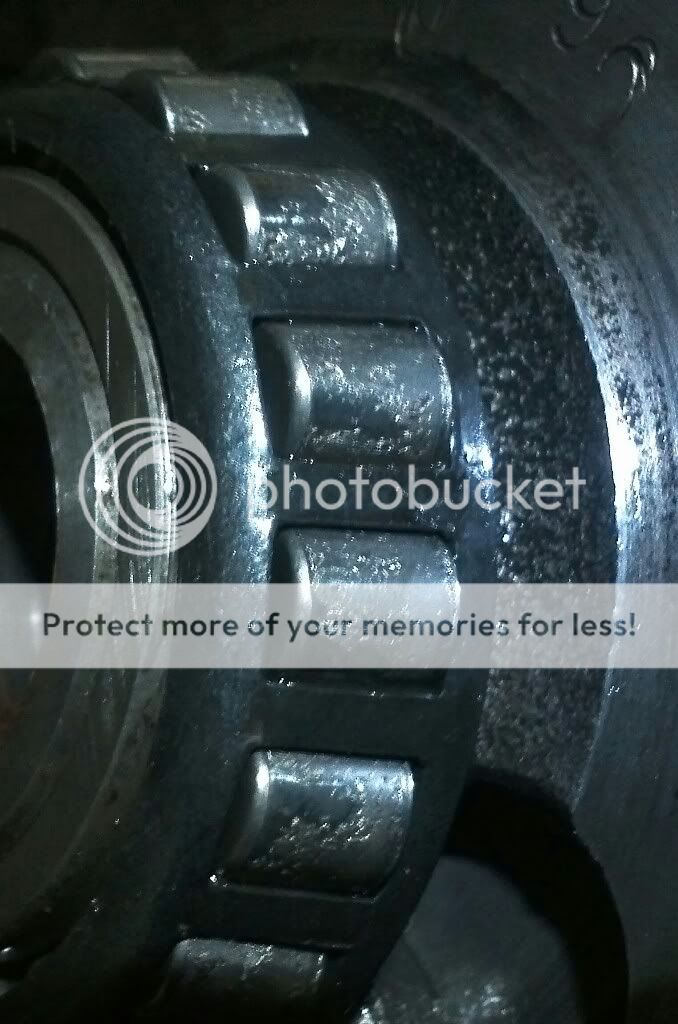

The R200 pretty commonly wastes the outer pinion bearing that is right under the pinion seal. You have to pull the carrier and the pinion to get it out, but it's not that big a deal if you're not changing shims or trying to set the pinion depth. I would bet that replacing that bearing fixes your problem. The problem is that the bearing is tough to get. I thought it was NLA at one point, but the older part number had been superceded by the 300ZX part number. Check with the dealer and see what you can do.
One guy actually had a ceramic bearing manufactured at one point. It was supposed to hold up better. Also there was some speculation that the problem might be static electricity jumping from race to race and if that is correct then a ground strap from the diff mount to the chassis might help (normally insulated by the mounts). I don't know if that one is true, but a ground strap is a couple $$$ at the auto parts store so I was going to do it on my car. Seems to me that I've seen this problem a lot more in the 300ZX, so my theory is that the 300ZX has the diff mounted at just enough of an angle to starve that bearing for oil.

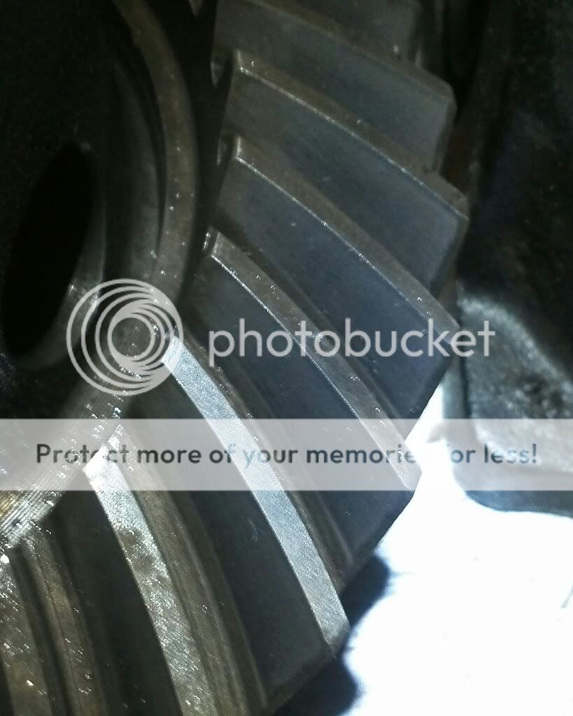

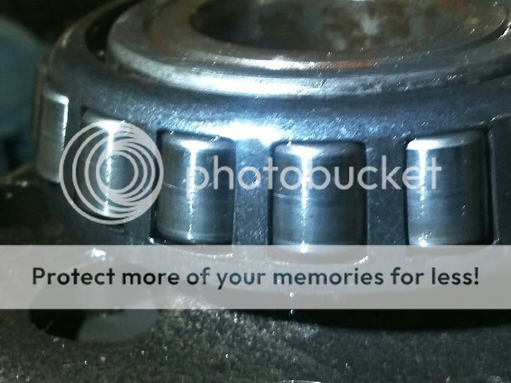

I pulled the differential apart today and found that one of the side bearings is also bad.
I'm going to replace all of the bearings. Is there anything else I should do while I have it apart?
