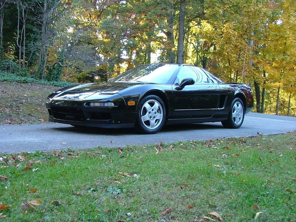

Wheelman13 Posted August 1, 2012 Author Share Posted August 1, 2012 What he said, I wanna see a link to pics. as I bought it (with half a dozen CEL codes, a dead ABS system, a few dozen electrical faults, blown shocks, and a questionable head gasket): In it's current state and it's natural environment, 237,000 miles and counting on the chassis and bottom-end Let me see a picture of your caliper brackets if tou could, I got some but not sure they are the ones I need. Honestly I've done more reading and I've got the wrong brackets. I thought the Maxima bracket part number carried forward, but it's apparently only the '81 cars that come with the brackets where the bolt "ears" are offset correctly. I'm now debating either buying some fab'd brackets from one of the vendors, having a friend modify these, or looking at going ahead with a 5-lug swap....although I'd like to drive the car in something close to a stock state before I go changing a bunch of stuff. Quote Link to comment Share on other sites More sharing options...
Leon Posted August 1, 2012 Share Posted August 1, 2012 Simply awesome! I would love to own (or at least drive ) an NSX someday. Quote Link to comment Share on other sites More sharing options...
Mikelly Posted August 2, 2012 Share Posted August 2, 2012 Great Supercar rescue man! Quote Link to comment Share on other sites More sharing options...

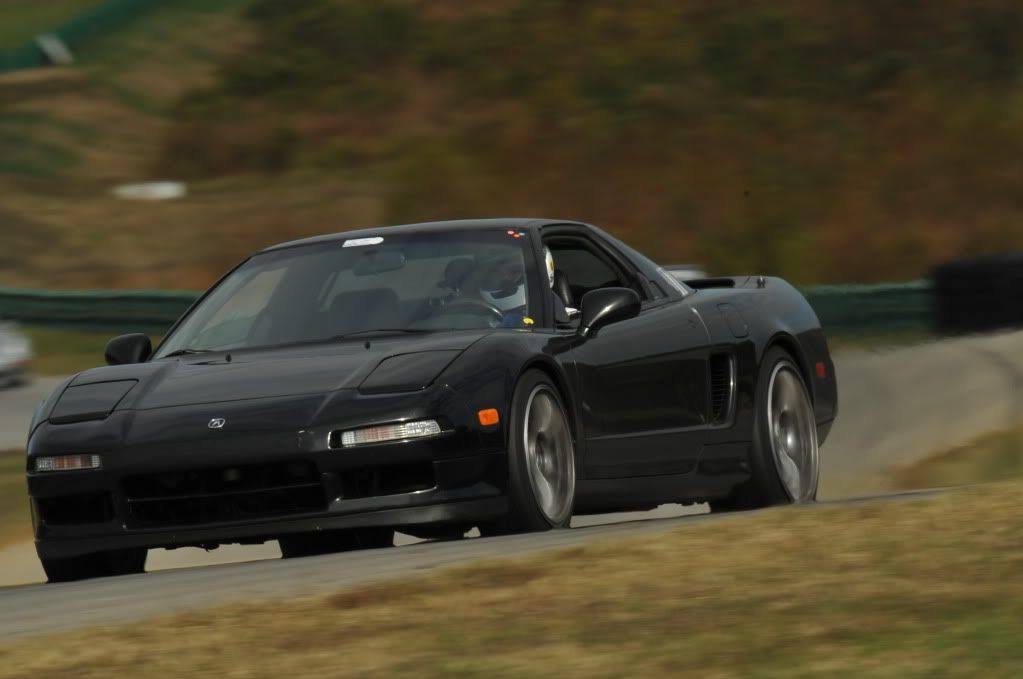

Wheelman13 Posted December 15, 2012 Author Share Posted December 15, 2012 (edited) Clearly that 9/22 deadline didn't happen. Instead, I completed the process to get my TT license and finished 2nd in my class at my first event with NASA-SE with the NSX. In the process, I think I found the limit for how fast one can take the kink at CMP: The other spindle pin was....."a bitch" would be understatement. I'd say, on a sliding scale, it was at least 5 or maybe even 6 raging bitches....but it's been sorted now. I'm in the process of media blasting the remaining suspension pieces and replacing the bushings/bumpstops etc. in the rear-end at the moment. I've also figured out the clutch thing. Apparently it's fairly common-place for the rod/bracket assembly connecting the MC to the pedal to not be long enough on the common parts-house MC kits. Not having an original to scavenge for parts, I bent up some aluminum bar-stock to make an extended/adjustable bracket assembly to screw onto the top of the actuator rod. This has, I hope, given me the necessary slave cylinder travel to fully-release the clutch. Hopefully my next update won't come after a 3.5 month gap..... Edited December 15, 2012 by Wheelman13 Quote Link to comment Share on other sites More sharing options...
BluDestiny Posted December 15, 2012 Share Posted December 15, 2012 lol 5 or 6 raging bitches. Do you have any shots of your nsx? Quote Link to comment Share on other sites More sharing options...
