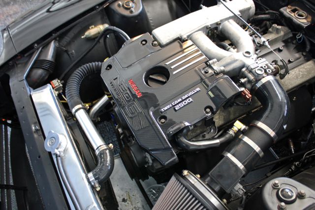

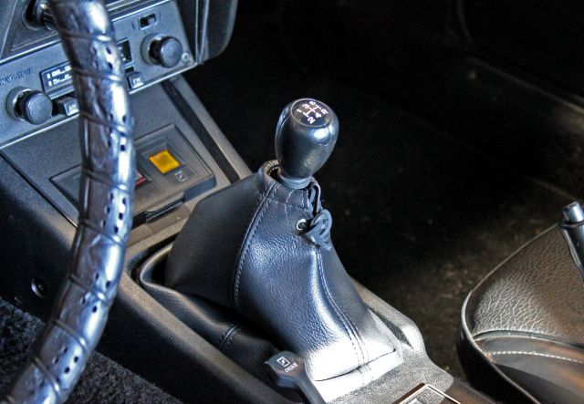

~KnuckleDuster~ Posted October 23, 2015 Author Share Posted October 23, 2015 (edited) Got the exhaust put back together, stayed with the old 3" crush bent so I wouldn't half to pay for a whole new set-up. It straight through with an 18" resonator and it's extremely loud. So loud I don't even want to drive it around. Sounds like I'm going 80mph when I'm only doing 30mph! I've got a small straight through 14" muffler on the way which hopefully will tone it down otherwise I may have to rethink the whole 3" idea. (edit: the exhaust was too loud due to some vac lines needing to be re routed and the ecu not being adjusted) The shift lever position was perfectly centered and I'm using a shift knob out of an old Datsun truck . Thread pitch is the same as the skyline and the white lettering flows well with the factory gauges and radio, nice stock appearance. I found this custom painted engine cover from a guy in Australia. It's made to look like carbon fiber weave and it's really hard to tell that it's not. I see black powder coated engine bits in my future.. Edited March 3, 2016 by ~KnuckleDuster~ Quote Link to comment Share on other sites More sharing options...
