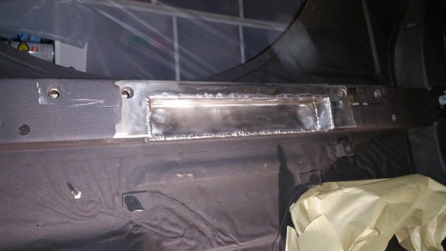

I talked to Gabriel when I discovered it wasn't a direct bolt in affair and he said the original kits had a lower mounting point for the R230 to the mustache bar but they raised it up for a better pinion angle.
The R200 setups don't require the modification.
