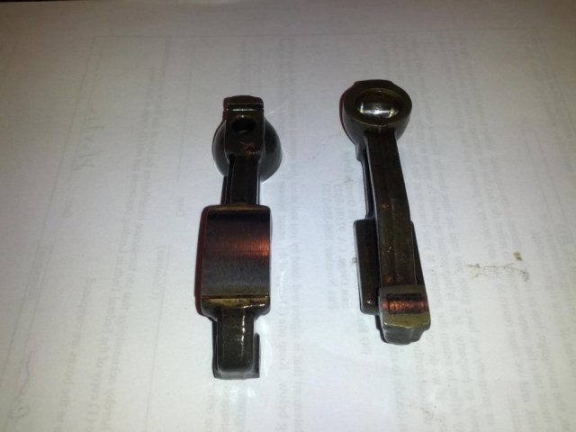

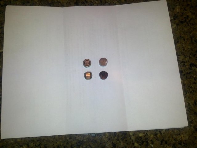

JCan Posted April 29, 2013 Share Posted April 29, 2013 Wow! Great find! Some lessons learned from my rebuild. 1) be sure to grind your rocker arms prior to reassembly. I did not and had problems with the rocker arms not mating squarely with the lash caps and the cam. (see pictures) The old lash pads wore in the middle and not on the sides, the new lash pads do not have the indentation on the sides so an unground rocker arm does not sit properly on the cap. This caused me a lot of time to find out why my engine had a loud tapping sound. 2) if you are going to purchase an isky cam. I ended up with the Isky stage II cam 715148 (see picture below). With my SUs the car is too lopy and too loud. This summer I am going to swap back to the isky stage 1 cam. I suggest the stage 1 cam. 3) I used cast flat top pistons on my N42, 2.8L block. The crank/block combination pushes the pistons above deck by approx 0.025" (0.65mm). I purchased a custom copper head gasket which was 0.063" (1.6mm) which gave me a gap between the piston and head of 0.037". When I ran the stock head gasket, I believe the piston to head clearance was 0.025" which concerned me. My resultant compression ratio is 9.83 instead of 10.2 with the Felpro gasket. 4) Please find shims that are 0.040" and use two instead of four of the 0.020" shims. I had mine custom made. it was inexpensive. Thats all I have on the head rebuild. Good luck! Jim Quote Link to comment Share on other sites More sharing options...

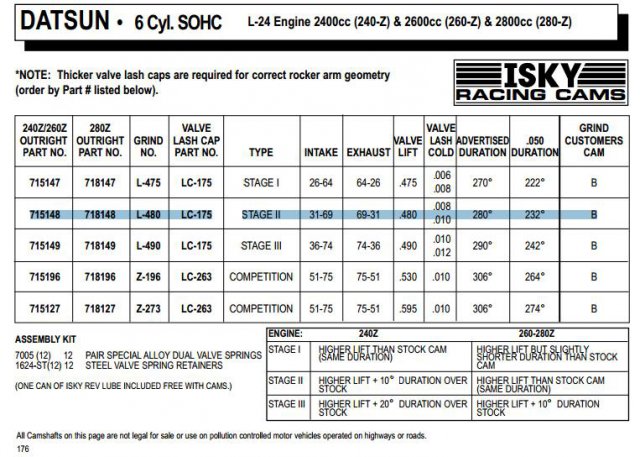

Leon Posted April 29, 2013 Author Share Posted April 29, 2013 (edited) On 4/29/2013 at 6:21 PM, tamo3 said: Looks good, $100 for that is great deal! Are you going to porting intake and Ext? Not really planning on porting, maybe just port-matching. My 45mm Webers are already port-matched to the Cannon intake. Ideally, I'd probably dump the Cannon and get a manifold made for 45s. From my PM conversation with gollum: if my power peak is to be 6500rpm, I need to be making 145lb-ft at the wheels in order to make 180whp. At 6000rpm, I need to have 158lb-ft at the wheels to make 180whp. My stock-cammed L24 makes ~140lb-ft at 4000rpm, so with a more aggressive cam and a 2.8, I think that should definitely be realistic. With that said, I'm not chasing horsepower. I just want something with a little more "umph" than my L24. It'll be mainly a street car so no wild cams and 9000rpm redlines... Edited April 29, 2013 by Leon Quote Link to comment Share on other sites More sharing options...
JCan Posted April 30, 2013 Share Posted April 30, 2013 Lazeum. This is one of those esoteric things that I learned the hard way! http://forums.hybridz.org/topic/110671-newly-rebuilt-engine-with-loud-tapping-noise-even-at-idle/ If the rocker arm contact point with the valve stem is not parallel with the rocker arm cam shaft contact point (is that a lash pad?) then gapping the valves will be almost impossible. When the rocker arm is parallel with the cam lobe then it is not parallel with the valve stem. When the engine runs the rocker arm with twist slightly and the engine will have a loud tapping sound proportional to the RPMs (if you go to the above blog I think I stored a short video clip) This happened on my car. Referring to the pictures on my previous post, look closely at the wear on the rocker arm on the valve stem side, you can see wear in the middle with no wear on the edges. When I used the new lash caps that were completely flat, the rocker arm contacted the lash cap on the edges of the cap not the middle. Long story short, after 2 weeks of removing the head, cam shaft, rocker arms over and over again, I finally found this issue. simple fix, I just ground the rocker arms so that they would contact the lash cap at only one place and it worked! Car is quiet and runs like it should! If you have questions, please call me - 858 204 9422 Quote Link to comment Share on other sites More sharing options...
JCan Posted April 30, 2013 Share Posted April 30, 2013 Leon. On the rocker arms, if the wear looks good on the cam side, you may not need to regrind that, although better safe then sorry. regrinding on the valve side is a must, it is simple to do, just grind away the edges so that the center has a slight crown to it. This ensures that the rocker arm will be flat with the cam and contact the valve at one point thus as you break in the motor, the rocker arm will self seat against the valve side and there will be no torque on the rocker arm. Jim PS We went to the motorsport show in LA this past weekend, car ran great! Even with all my fancy tricks to limit HP (high gear ratio + SU carbs) once the car hits 30mph, the car pulls really well! Quote Link to comment Share on other sites More sharing options...
