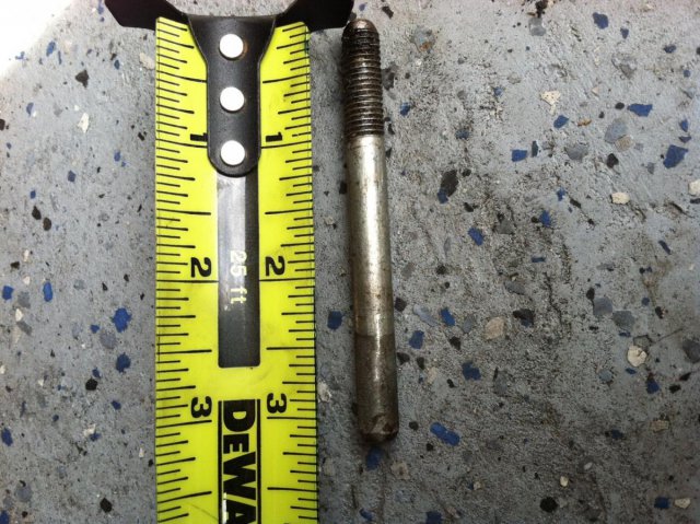

Ben's Z Posted February 25, 2013 Author Share Posted February 25, 2013 (edited) Ok, I took out and installed my new throwout bearing collar today, it was shorter than the other one. I also used a Turbo clutch fork. I went to install my slave cylinder again, and the rod was still too long. I said to hell with it and cut down the rod some. I took a picture of the rod next to my tape measure. I don't even think this is the correct rod. What is up with these threads? I took off about 1/4-3/8 of an inch and now my clutch seems like it has too much slack. I have not tried adjusting it thought. What are your thoughts on this rod? Wrong one? Some redneck ingenuity? Edited February 25, 2013 by Ben's Z Quote Link to comment Share on other sites More sharing options...
NewZed Posted February 25, 2013 Share Posted February 25, 2013 You must be getting parts from your doppelganger. Here's an old slave cylinder I took off a 78 280Z. Quote Link to comment Share on other sites More sharing options...
Ben's Z Posted February 25, 2013 Author Share Posted February 25, 2013 On 2/25/2013 at 1:46 AM, NewZed said: You must be getting parts from your doppelganger. Here's an old slave cylinder I took off a 78 280Z. The previous owner had the trans rebuilt. Who the hell know how that got in there. I will measure my cut down rod to that picture there. I can get a used rod from a local Z friend if need be. Quote Link to comment Share on other sites More sharing options...
