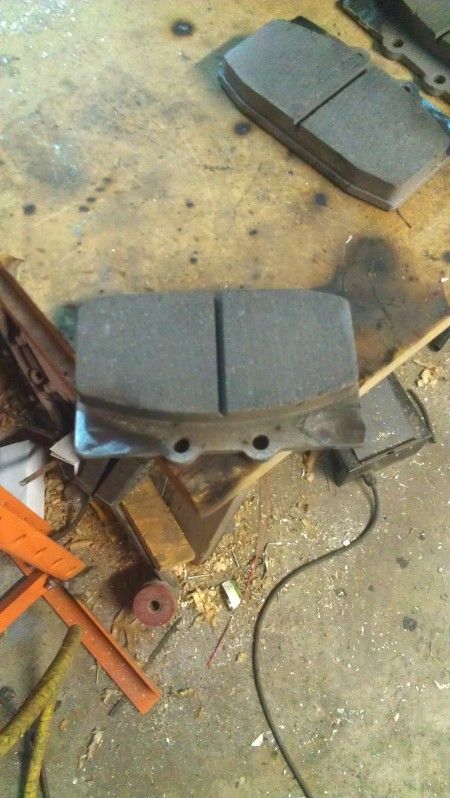

Xnke Posted February 15, 2013 Author Share Posted February 15, 2013 (edited) It's pretty simple, you take an old toyota pad, and a new RX-7 pad, and look at the two. The pads are very similar. The difference is the RX-7 pad as a little more pad material at the bottom two corners, and that the two holes in the top left and top right corner are too high on the backing plate to put the pad material in the right spot. SOME pads have a squealer tab at the bottom center, just cut this off, it'll hit the rotor hub otherwise. Weld the two corners up solid; grind the backer plate flat again, and put the toyota pad and the RX-7 pad back to back. Align the top edge of the pad material, then clamp them together and drill the pin holes through, using the toyota pad as a template. Nothin' to it. I don't have a photo of drilling the holes, just the welded up and ground flat pad...forgot to take that photo. Those two center holes don't get moved...they are just to hold the anti-squeal clip and they fit fine. Edited February 15, 2013 by Xnke Quote Link to comment Share on other sites More sharing options...

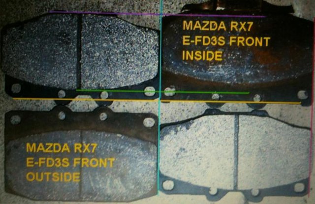

Gareth. J. Posted February 27, 2013 Share Posted February 27, 2013 (edited) I also used these pads in my hilux front calipers, carried out the same welding mod too. Good track pad options are limited for these here in Australia. Here's a comparison pic between the hilux and mazda pads Edited February 27, 2013 by Gareth. J. Quote Link to comment Share on other sites More sharing options...
