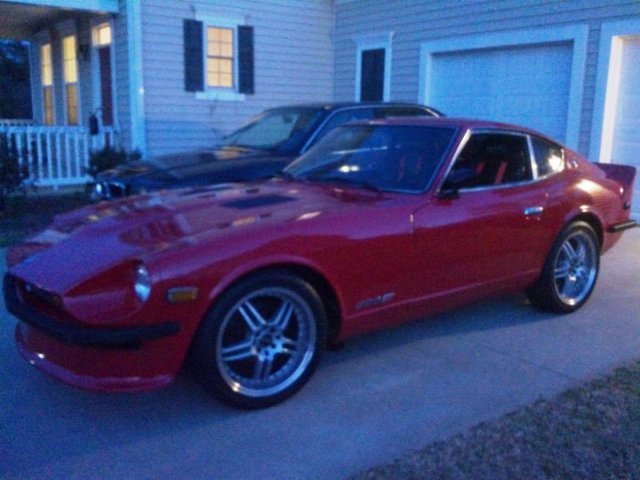

RangerWill Posted March 10, 2013 Share Posted March 10, 2013 Little background, I have a 77 280z. Ive been working on for about 5 years between deployments and the Army moving me here and there. Not a lot done to the motor. Lots else where though. MUAH HAHA . - Shaved intake, ISK fuel rail W/ gauge, Fuel lap pressure regulator, 240SX TB, MSA 6-1 header, Fireball coil, Thunderbolt plug wires,MSA cold air intake, NGK plugs, new stock injectors ISSUE - Motor very hesitent to fire up after any lengh of driving. I could start it and then fire it right back up and it struggles. Has to have an all night cool for it to fire right up. Otherwise Im on the starter 3 times of about 10 seconds to get it to hit and fire up. Once it does it runs like crap for about 5 mins and the as normal. I have read and read posts hopeing to find the answer and thought I had with Heat Soak. Thinking my Fuel in the Rail was vaporizing and then not wanting to fire the car off. Not the case I believe. To combat this I installed a hot switch to my fuel pump and disconnected the normally driven wiring. My plan was to simply run the fuel out of the rail and in theory there would be no fuel to Vaporize. Once I was ready to start it up again, flip of the switch to once again pressurize the rail with some fresh fuel. Sounds to me like this would work. WRONG! Damnit...... haha. I was actually starting to fab up a heat sheild until my hot switch fuel pump idea. Since I know there is no fuel in the rail to Vaporize Im at a TOTAL LOSS.................................... So tired of my car running like a damn champ and then not wanting to start up. It just runs to well to think of the common plugs, points, cap issues. I need your help guys. Its driving me INSANE not being able to figure this out. Hell, Id even PAY $$$ to get this issue resolved. Yes, Its come to that. PLEASE HELP. haha. Heres a pic of my Beautiful BABY........................... Quote Link to comment Share on other sites More sharing options...
