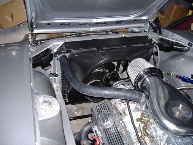

HarrisonTX Posted April 8, 2013 Share Posted April 8, 2013 I've been considering an ebay radiator. Hard to beat $140 for a bolt in aluminum rad. I run an ebay Chinese radiator in my malibu with a 406 chevy and have never had issues, and that's here in Texas Any one try one yet? http://www.ebay.com/itm/3-ROW-Nissan-Datsun-240Z-260Z-1970-1975-Aluminum-Radiator-AT-MT-New-1971-1972-73-/261126499728?pt=Motors_Car_Truck_Parts_Accessories&fits=Model%3A240Z&hash=item3ccc5a2d90&vxp=mtr Quote Link to comment Share on other sites More sharing options...
