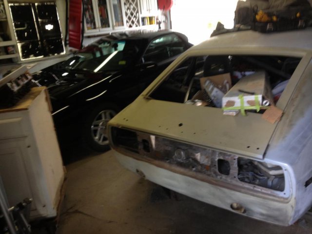

Hi guys.  My Z has been in a state of restoration for several years and basically been sitting after I had a small accident with it.  I had the body completely stripped and media blasted several years ago.  I was working on it with a slightly unstable but good body guy who one day showed up to my house, set off the alarm, took his tools and left after having a temper tantrum because he had cut holes in the rear valance for through dual exhaust in the wrong spots twice.  Nothing like having an unstable person in their mid-forties losing it and throwing tools around the garage.  fun is.
I want to get her going again but parts are everywhere from having moved twice since it was taken apart.
I need assistance figuring out the most logical way of reassembling the doors and what parts are needed to do so.  My parts are in plastic totes and in a few spots in the house, and I'm having a very hard time determining where to start and what parts to start with....  Any help? Pretty please.

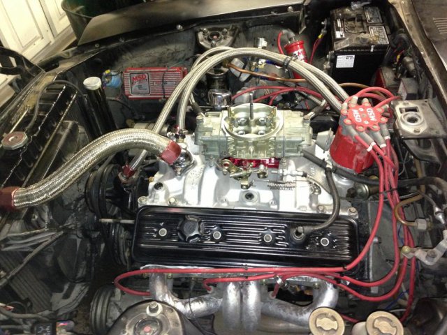

Thanks. Don't have a fsm. Just trying to get the parts found and organized is proving to be a challenge at this point. I don't know anyone nearby with a z for me to take a look at so there is going to be some trial and error. I finally got it running again. I had taken the heads off years ago in an effort to create a drag race style engine but I gave up on the idea. I grabbed a set of vortec heads off a friends truck took them apart cleaned them up and put them on. Two of the head bolt holes stripped out during the install creating more roadblocks. After alot of late nights, it fired up Saturday night giving me renewed motivation on the project. :)
