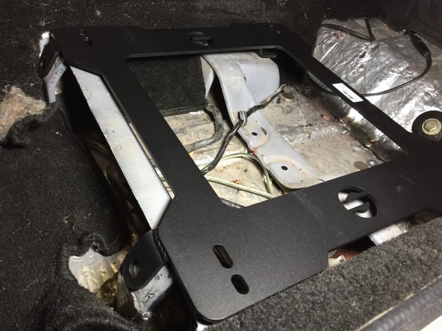

thedarkie Posted January 1, 2015 Share Posted January 1, 2015 (edited) The distance left to right (center to center) was 12.5" +/- I suggest you snap a photo of your floor, measure the holes side to side as well as front to back and take special note of whether the rear holes are flat or angled (scroll up for my pic) and then send that info to sales@plantedtechnology.com if you can use their brackets. Jeff helped me out a ton- the bracket they had listed (and Sparco) for 74+ cars didn't fit at all in mine. I had to send him the measurements and photos and it turned out they designed brackets for my specific car as well- they were just never sure which particular model years were what. My car (and possibly yours) was an oddity, but they manufactured bases for it anyway. This is the bracket they first sent me for a '74 car- note the rear mounting tabs. After we figured out what I needed, they sent me the right brackets with angled tabs front and back. ^^^ are your seat rails 13 inch from left to right mounting holes ? I have a 10/74 260z and am looking at bride rails ....they make them for our cars but the dimensions listed under my year are totally different from where my mounting points are. Edited January 1, 2015 by thedarkie Quote Link to comment Share on other sites More sharing options...

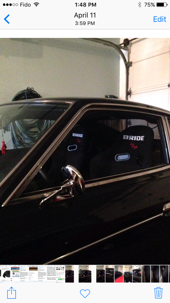

Rob L Posted December 8, 2015 Share Posted December 8, 2015 Hey kona41.....just saw this now ....here is a pic of my brides installed... Quote Link to comment Share on other sites More sharing options...
kona41 Posted December 12, 2015 Share Posted December 12, 2015 Hey Theatriks! Looks great! What are you using for a harness bar? I am thinking of going with the Autopower/ motorsport scca bar. Just concerned about getting the seat back far enough, and head clearance. I am 6'4" so this will raise some concerns with helmets. Finishing suspension up. but did get driver seat out and the planted brackets line up mint. Teknotik is a dealer in Canada. talk to Eric Quote Link to comment Share on other sites More sharing options...
