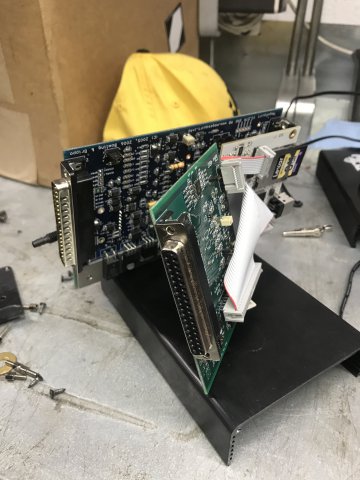

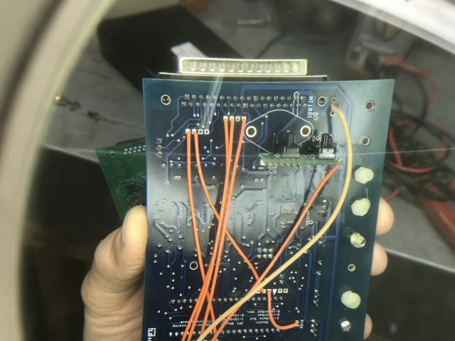

madkaw Posted December 27, 2018 Author Share Posted December 27, 2018 Yes - I did some reading and realized that it needed to be mounted on top of the intake- which probably isn’t going to happen. I don’t think I’m ready to give up on the IAC . Besides - I’m having other issues right now I’m pretty sure my CAS is giving me issues - so I’m troubleshooting it right now. Found greasy condensation mess in my PCB coming from my MAP sensor . Also checking voltage for my VR sensor circuit. Quote Link to comment Share on other sites More sharing options...
