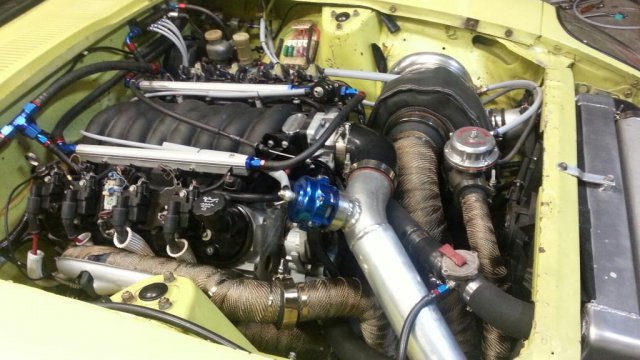

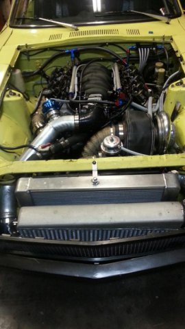

Z-Gad Posted July 8, 2013 Share Posted July 8, 2013 (edited) After 5-6 years of having the 2JZGTE in my 71 240z, I developed a rod knock last fall. I was going to pull the engine and rebuild it, but decided to make a change... I spoke with Scottie GNZ, and he graciously said, "I know you don't have the time or resources up there (being relatively new to the area up here), bring the car down here and I'll do the install". I spoke with my machinist in Orlando, told him I was wanting to do a built LS1 turbo, and he said, bring it down too... So, I sold all of my 2JZ parts, and began buying LS1 parts, packed up the car and parts and dropped them off in Orlando. I just picked up the car last week and I am grinning ear to ear General build is a GEN IV 6.0 block, Forged Pistons, Eagle rods, World Warhawk heads with inconnel valves, 595 lift cam, modified truck manifolds, single 3" full exhaust (all that would fit past the starter (for the street), and a straight 4" dump that exits in front of the right front tire for the track, Turbonetics 82mm turbo, 45mm Turbonetics wastegate, Treadstone intercooler, 1000cc injectors, stock LS1 intake and tb for now, Megqsquirt 3 EMS, compression is around 9.0:1, TH400 with straight cut gears and 3600 stall... BIG thanks to Scottie for all his tireless work, and to Dover Orlando for the sweet engine build.. Anyway, more to come as I get tuning and track times, and here are the pics ... Edited July 8, 2013 by Z-Gad Quote Link to comment Share on other sites More sharing options...

Z-Gad Posted July 8, 2013 Author Share Posted July 8, 2013 (edited) Thanks all for the kind words!! Boost - 5 psi on the street and I can feel the single 3" exhaust choking it up, besides, anything more and it just blows the tires away. I intend to run up to around 20psi at the dragstrip, but I'll creep up on it Rear end - Techno-Toy-Tuning rear end setup with the Moser splines 300zxTT axles and 2.94 geared Armada R230 diff and 300zxTT LSD unit installed race tires - 26x11.5x15 ET streets and M/T frontrunners I will most certainly keep you all posted as the car progresses... I suspect Scottie will chime in with some expletives from the install LOL Edited July 9, 2013 by Z-Gad Quote Link to comment Share on other sites More sharing options...

Scottie-GNZ Posted July 8, 2013 Share Posted July 8, 2013 Expletives? This is a family forum, isn't it? I'll keep them to myself, LOL. It was quite a challenge stuffing a 900+rwhp-capable turbo V8 in there while retaining the stock hood, giving it a full street exhaust, retaining the grille, retaining the big front swaybar, and minimizing cutting up the car. I have no doubt it is capable of running 8.50. My Mustang has gone 8.7 with only 17.5psi and this is 300lbs lighter and with a intake upgrade will make more power. It got my attention with a 5# WG spring and the WG turned off. Take your time dialing it in, Mike and be careful testing it on the street, especially with the DP uncapped. Quote Link to comment Share on other sites More sharing options...
