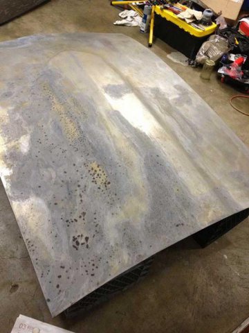

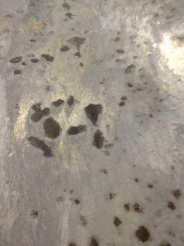

tamo3 Posted July 27, 2013 Share Posted July 27, 2013 (edited) Hi, I'm working on stripping paint and fix rust area. Yesterday, I use AirCraft Paint stripper and wash and sand the hood. There are several surface rust spot. I got POR15 tryout kit and use "Prep-Ready" for those surface rust spot. Some spot bobble up and some are not. My question is is it OK to leave this as is and apply Epoxy primer? or do I need to sand down completely to remove rust black spot to the same color with other bare metal? Thanks, tamo3 Edited July 27, 2013 by tamo3 Quote Link to comment Share on other sites More sharing options...
morbias Posted July 27, 2013 Share Posted July 27, 2013 You need to remove all of it unless you want it coming back! Use a wire wheel drill attachment to get the rust in pitted areas, then use prep-ready / phosphoric acid to kill off any microscopic rust. Make sure there is no acid left when you prime though, in fact I would wire wheel the whole thing over again to make extra sure. Quote Link to comment Share on other sites More sharing options...
tooquick260 Posted July 27, 2013 Share Posted July 27, 2013 As morbias said , wire wheel as much as you can then use some type of rust inhibitor/remover. I have seen my dad use ospho. You brush it on, turns black. This stops the rust process. Something about anodotic/cathodic effects of metal. The rust spots are area's that are giving up or sacrificing itself. After using the ospho spray with etching primer and your good to go. Or atleast for 20+ years. Quote Link to comment Share on other sites More sharing options...
tamo3 Posted July 27, 2013 Author Share Posted July 27, 2013 Thanks for your advice. I will do that! Quote Link to comment Share on other sites More sharing options...
