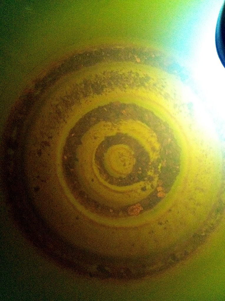

JPN_Garage Posted September 11, 2013 Author Share Posted September 11, 2013 Checked my new fuel filter and it was a little dirty so after draining the tank this is what comes out. Its a bucket full of fuel and rust at the bottom, so i will be pulling the tank out and cleaning it. Quote Link to comment Share on other sites More sharing options...
tooquick260 Posted September 11, 2013 Share Posted September 11, 2013 That looks nasty..... Makes me wonder about mine? I think i will use dads scope and take a look! Quote Link to comment Share on other sites More sharing options...
