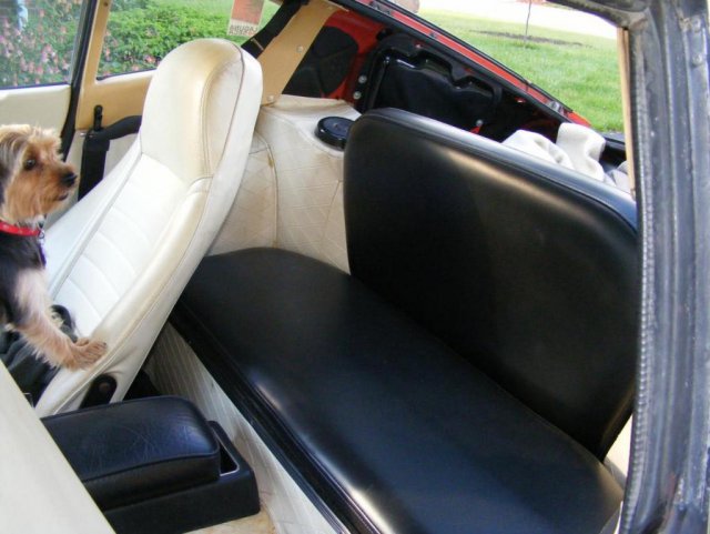

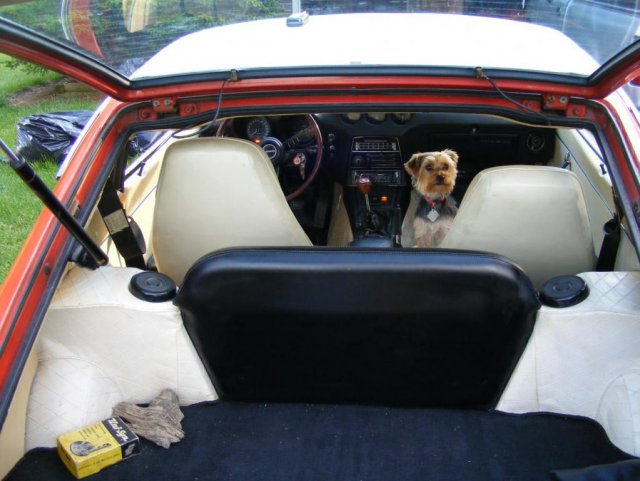

clearly space would be a bit cramped but i think with minimal modifications it could be done... I have two small speaker boxes behind my seats that i plan on removing, putting the speakers directly into the sheet metal and in the little cubby things, then drilling a rail inbetween an around the cubbies to put a bench seat on and small people can dangle their feet behind the front seats. with the rail the seat would be able to slide backwards and forwards so the cubbies could still be used..... ideas? suggestions?

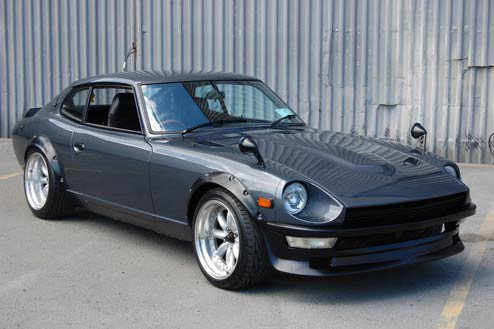

I've been considering doing this to my 240z for a while. My kids are 5 and 8 and could fit in a really small seat for a few more years. Also, I just don't like the body lines of the 2+2. I had seen the photos Plata posted in the thread earlier and it doesn't seem too hard of a project. I also think doing something like the early 911's would work pretty well too.

That being said that dark grey 2+2 that Plata posted is the best looking one I've ever seen. If I was just starting a project now I would probably look for a 2+2 and do something similar.

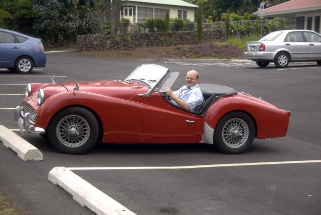

But , IMO an early Z is far safer in good hands compare to this fine Brit  Classic post-36683-0-23706500-1379007820_thumb.jpg and FWIW on Ebay a 2+2 (with factory back seats and belts) for a song http://cgi.ebay.com/ebaymotors/1978-Datsun-280Z-2-2-Automatic-/300962123397?pt=US_Cars_Trucks&hash=item4612bd8e85#v4-42  :icon12:
