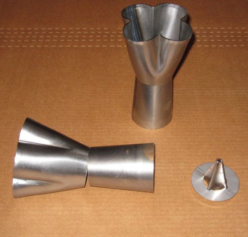

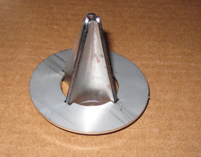

JMortensen Posted September 13, 2013 Share Posted September 13, 2013 (edited) Just got these in, they look pretty damn cool so I thought I'd share. It's a collector with a "bullet" or "spike" to smooth the transition from the end of the 4 primaries to the collector. I hadn't ever heard of these but read a page on side pipe testing and they tried them and found a pretty consistent 11 hp on a motor that was making something like 500 hp if I recall. Cone Engineering (www.coneeng.com) makes 3 to 1 collectors too. This is a "merge collector" like Burns Stainless sells as well. I wanted 2.5" collectors, so this narrows to 2" and then tapers back out to 2.5. They have 3 different tapers, and say that the sharpest one has a larger effect on high end power and the slowest taper makes better low end. I picked the middle one. The collector kit with 2 collectors, These parts are mild steel but they have the same thing in stainless, and they have muffler parts too. Really cool stuff, and the mild steel collectors were $115. Seems pretty cheap for a serious looking piece. I don't mind the DIY aspect when compared to the price of the Burns equivalent. Edited September 13, 2013 by JMortensen Quote Link to comment Share on other sites More sharing options...
74_5.0L_Z Posted September 14, 2013 Share Posted September 14, 2013 Those are cool. If I hadn't already purchased the slip-on merge collectors that I used then I would definitely have used the Cone Engineering collectors. Quote Link to comment Share on other sites More sharing options...
1 tuff z Posted September 14, 2013 Share Posted September 14, 2013 I purchased components from Cone. Spent time on the phone with the owner and received a nice 'exhaust education' at the same time. Very informative and high quality products at a very reasonable price. As Jon mentioned, a great bargain for us DIYr's! Quote Link to comment Share on other sites More sharing options...

johnc Posted September 15, 2013 Share Posted September 15, 2013 That spike or a modified version of the has been around for a while. Gale Banks has them on their truck headers with a rounded tip and they call it the "power pickle." Quote Link to comment Share on other sites More sharing options...
