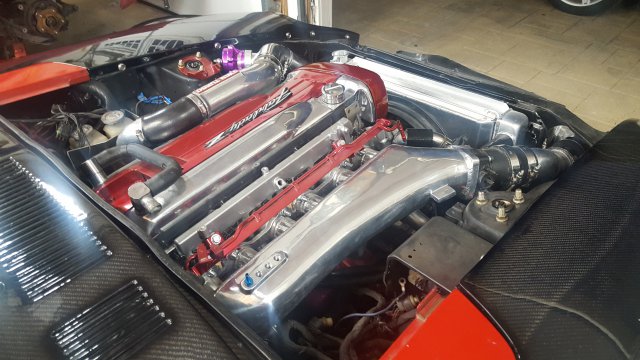

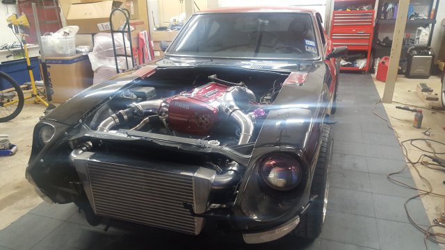

Arif Posted January 8, 2018 Author Share Posted January 8, 2018 Well I think I'm averaging one post a year so here it is. First I'd like to thank those that pointed out the issues with the roll cage. When I took the car to the fabricator he mentioned the same thing and even said it was dangerous. So for those looking to follow in my footsteps don't install the cage like that. Now to the fun stuff. The car spent 3 months at the fabricator getting the following items taken care of: 1. Custom intercooler mount and piping 2. Radiator mounted along with piping 3. Full exhaust off the downpipes 4. Modified the 350z bellhousing to accept the Collins Adapter, custom shifter linkeage and Datsun Roadster starter 5. Modified diff mount 6. Mounted S2000 seats 7. Complete AC system!! I'll install the front airdam, driveshaft, pulleys before it heads off for tuning. It's looking like I'll be able to get it tuned in a couple months after my car fund recovers. 1 Quote Link to comment Share on other sites More sharing options...
boosted300 Posted March 16, 2018 Share Posted March 16, 2018 How is this project coming along? Also a question: did you get the baffled Treadstone end tanks? Quote Link to comment Share on other sites More sharing options...
Arif Posted March 16, 2018 Author Share Posted March 16, 2018 1 hour ago, boosted300 said: How is this project coming along? Also a question: did you get the baffled Treadstone end tanks? I'm getting really close to getting it tuned. Just need to wire up the fan, order driveshaft, install throttle cable and a few more items. I've also got a Z32 and a AMG CLS63 that needed some attention which slowed me down a bit. Hopefully I've be on the road with it by May. The Treadstone IC I bought didn't have the baffle as an option. Do you know what the benefit of having it is? Quote Link to comment Share on other sites More sharing options...
boosted300 Posted March 16, 2018 Share Posted March 16, 2018 17 hours ago, Arif said: I'm getting really close to getting it tuned. Just need to wire up the fan, order driveshaft, install throttle cable and a few more items. I've also got a Z32 and a AMG CLS63 that needed some attention which slowed me down a bit. Hopefully I've be on the road with it by May. The Treadstone IC I bought didn't have the baffle as an option. Do you know what the benefit of having it is? Yes, it helps to spread the flow of the air through the entire core of the intercooler to maximize efficiency. And I know what you mean...I have Z31 that has been sorely neglected because of my S30...but I WISH I had a CLS63! Good luck with the build, I'm looking forward to seeing it come to fruition. Cheers Quote Link to comment Share on other sites More sharing options...
Arif Posted March 17, 2018 Author Share Posted March 17, 2018 6 hours ago, boosted300 said: Yes, it helps to spread the flow of the air through the entire core of the intercooler to maximize efficiency. And I know what you mean...I have Z31 that has been sorely neglected because of my S30...but I WISH I had a CLS63! Good luck with the build, I'm looking forward to seeing it come to fruition. Cheers Ah ok. I have the TR1235 which has a divider on the inlet. I see you went with the Bell intercooler. Their shop is about 20 minutes from my house. Our Z club had a tech day there a few years ago. Corky is a legend in the turbo game. The CLS63 is a lot of fun. It's a 2007 model and I took it into the shop to get an estimate to get some work done on it and let's just say I brought the car back home after that quote. I learned how to replace the intake manifold gasket, PCV valve, front air struts and window regulators. They aren't that hard to work on but labor is ridiculously expensive. Quote Link to comment Share on other sites More sharing options...

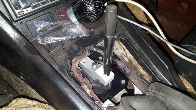

Arif Posted March 17, 2018 Author Share Posted March 17, 2018 Just realized I hadn't shared the transmission (CD009)set up. I used the forward mount CBF shifter relocator with the adjustable lever. This put the shifter in the perfect spot for me. I also used the Collins adapter and a Datsun SPL311 starter which required additional cutting on the bellhousing. Before I forget. Originally my plan was to use the RB25 bellhousing with the Z32 transmission. Eventually I changed my mind and went with the 350z transmission. I had already bought the TT clutch for the Z32 so here I was stuck with a clutch I had never used. I decided to call Southbend to see if they would be willing to swap clutches and to my surprised they agreed! All I had to do was pay to ship the Z32 clutch to them. Now that's amazing customer service. Quote Link to comment Share on other sites More sharing options...

KevvinG Posted September 17, 2018 Share Posted September 17, 2018 Holy smokes Arif this is amazing! Your Z and mine are basically clones drivetrain wise! I've got a built RB26 with a big single turbo swap and I'm running the CD009 out of a 350Z with a collins performance adapter! I haven't had a chance to install it yet as I'm still handling some chassis upgrades/rust repair. How does the cbf shifter fit? It looks like it's a touch forward in the hole. Also, how does it install? Keep this thread alive! It's awesome seeing such a similar build happening at the same time as me Quote Link to comment Share on other sites More sharing options...
Arif Posted September 20, 2018 Author Share Posted September 20, 2018 On 9/17/2018 at 12:42 PM, KevvinG said: Thanks Kevin! It's been a long road that hopefully I'm closer to the end. The shifter fits great however I do need to follow up with them to see why the shifting is so sloppy. I think I'm missing something. I'm running an old SDS engine mgt system that was used on my old L28et. I need to call SDS to see about getting a new wiring harness. If it's an easy swap I'll stick with it but if it requires a lot of hacking I'll go with something more modern. That's the final piece of the puzzle to solve then it's off to tuning. Quote Link to comment Share on other sites More sharing options...
KevvinG Posted September 20, 2018 Share Posted September 20, 2018 18 hours ago, Arif said: Thanks Kevin! It's been a long road that hopefully I'm closer to the end. The shifter fits great however I do need to follow up with them to see why the shifting is so sloppy. I think I'm missing something. I'm running an old SDS engine mgt system that was used on my old L28et. I need to call SDS to see about getting a new wiring harness. If it's an easy swap I'll stick with it but if it requires a lot of hacking I'll go with something more modern. That's the final piece of the puzzle to solve then it's off to tuning. Please keep this thread posted with CBF's response re: the sloppy shifter! I'm looking to see if I can find a rear mount shifter that would still fit before I spend the big $$ on the CBF forward mount shifter! Quote Link to comment Share on other sites More sharing options...

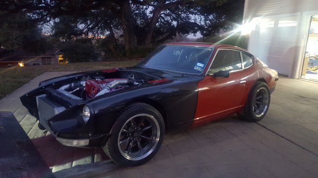

Arif Posted November 12, 2018 Author Share Posted November 12, 2018 I got so much done this weekend. Mounted the SDS coil pack, assembled plug wires, hooked up the boost controller and ran the fuel lines. The to do list is getting shorter and it's almost time to start her up! Quote Link to comment Share on other sites More sharing options...
