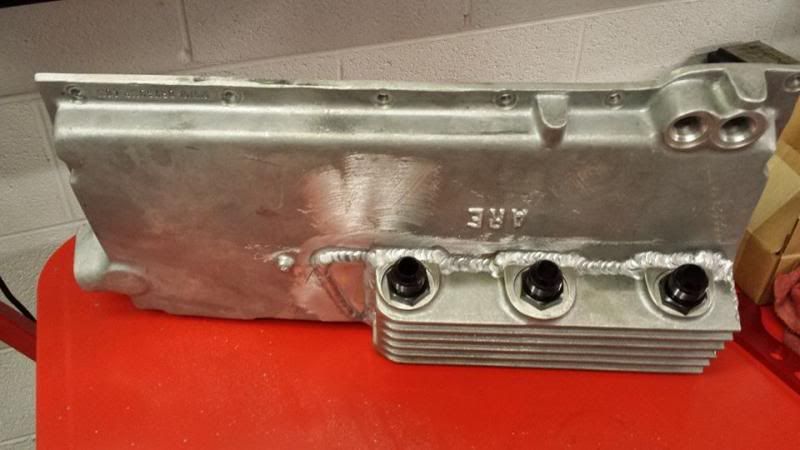

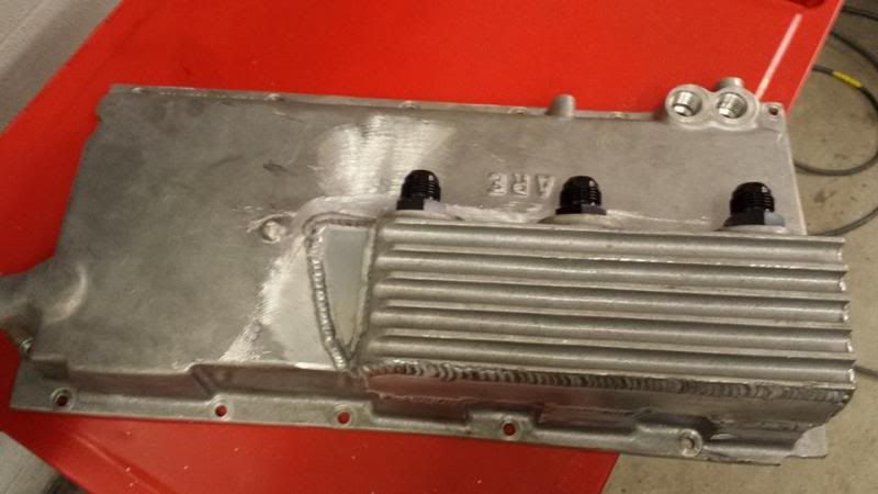

Some progress with my drysump system... We had to flip the sump on the ARE pan to clear the header on the passenger side...
1510415_799621406720952_1644565965_n_zps
1525675_799621333387626_1055467275_n_zps

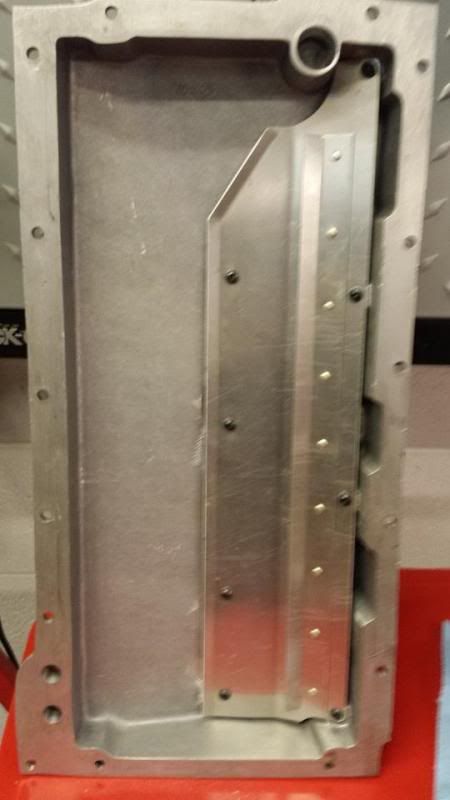

Fortunately the windage tray in the bottom of the pan will aid in controlling the drain drag from the crank...

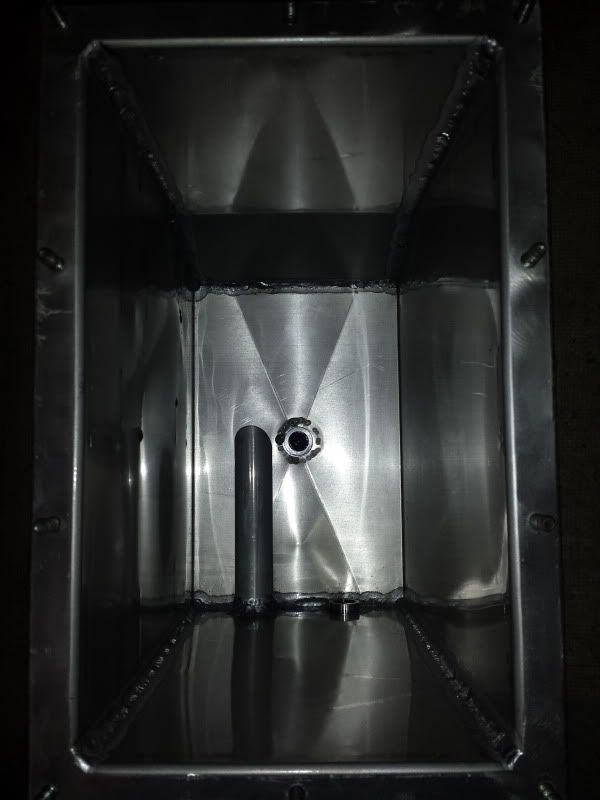

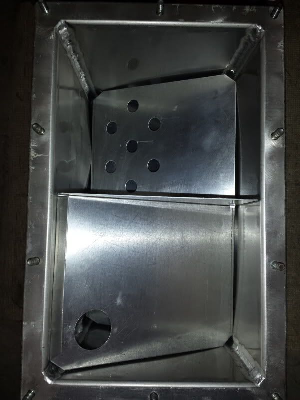

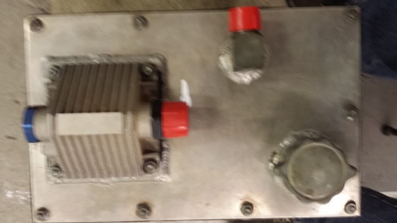

And I went ahead and ripped appart the BulterBuilt drysump tank and cleaned it out...

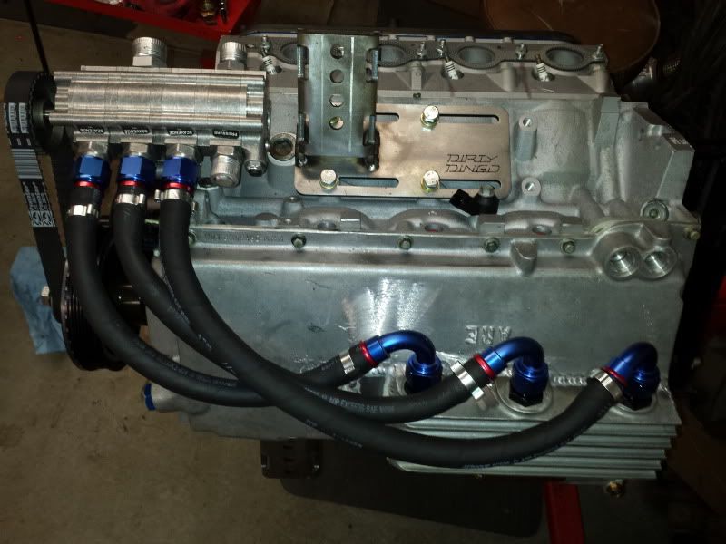

And I went ahead and made up some lines and mounted the oil pan...

I couldn't find ANY info on Vacuum springs in the scavenge hoses or where anyone has said "You must instal these or else."   I also have found exactly one source for the springs, Pegasus...

Based on the reading, and the three phone calls completed this week, I'm not concerned at this point with the hoses I chose causing issues on the scavenge side.  I am running three scavenge stages, and from what I was told by John Barilka (Hendrick) and Steve Wilson (Childres) I shouldn't have issues.  Motor won't spin north of 6500 and the vacuum is going to be right around 7-8.  Shouldn't be an issue.  Also, the hose manufacturer said there should be no issues at all with that hose collapsing.

All manufacturers of hose will have limits for their products.  These will lbe temperature limits, working pressure, burst pressure, bend radii, and vacuum for each hose family.  Some of the newer high tech hoses can handle vacuum fine (Starlite, BMRS, etc.).  But best to check your master catalog to know.  If you need to make a sharp turn from the pump to the pan is another issue.  So if either of these are the case then you'll need what's called AN hose inner support springs.  You can find these at Jegs, speedway, summit, etc.  Each manufacturer will have a special version for their hose if needed.
The problem is that the pump generates considerable suction and when the oil heats up the hose it gets very pliable.  These springs will keep it from momentarily pinching off.  If that happens you loose oil supply and bad things happen.  It's not as big an issue on the scavenge side but you still don't want a hose getting pulled shut.  It all comes down to the pump and the hose rating.  It's not whether or not the hose is any good.  General rule of thumb is on any of the new high tech hose solutions the non-metal braided hoses will not have enough vacuum resistance to be used in a dry sump system.
I'm using BMRS progold plumbing for my dry sump and section 1.2 of their master catalog lists AN 12 hose as being capable of withstanding 28 inches of mercury of vacuum at a minimum bend radius of 2.5 inches between -57 to 400 degrees Fahrenheit.  At diameters larger than AN 16 these ratings drop quite a bit.
