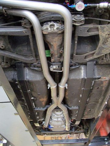

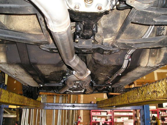

PLATA Posted November 22, 2013 Share Posted November 22, 2013 (edited) This mod is essential on a mid 12's Z with an LS1 mill, I have the same type on my Z and glad that was part of the conversion this is the custom made set up on Z VETTE. The lower pic is another application FWIW Edited November 22, 2013 by PLATA Quote Link to comment Share on other sites More sharing options...
