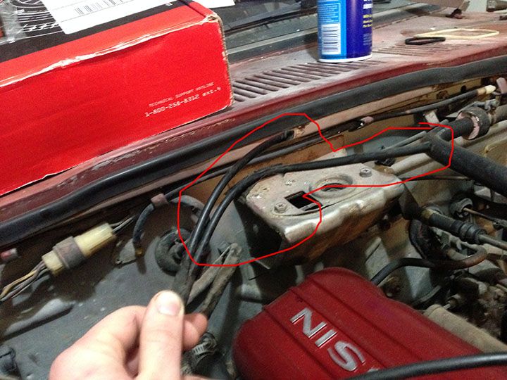

Spirit7 Posted January 20, 2014 Share Posted January 20, 2014 I'm trying to get everything back together on this incomplete z I bought. Does anyone know what hose is supposed to be hooked up here? I removed the smog pump, so it might be linked to that? Quote Link to comment Share on other sites More sharing options...
seattlejester Posted January 20, 2014 Share Posted January 20, 2014 (edited) Crank vent hose, it routes the oil saturated air generated from the pistons moving up and down to the balance tube between the carbs to be burned. Edited January 20, 2014 by seattlejester Quote Link to comment Share on other sites More sharing options...
OldAndyAndTheSea Posted January 20, 2014 Share Posted January 20, 2014 Yep, that hose connects from the area in your picture, to the middle of the intake manifold balance tube (where the PCV is located) There's a special braided hose that fits there. Quote Link to comment Share on other sites More sharing options...
NewZed Posted January 20, 2014 Share Posted January 20, 2014 Oil-saturated air wouldn't really be a problem inside the crankcase, that would just be airborne lubrication. Combustion byproducts that get by the rings, aka blow-by, are the target of the PVC tube. Quote Link to comment Share on other sites More sharing options...
Spirit7 Posted January 20, 2014 Author Share Posted January 20, 2014 (edited) Ok, so it runs to the PCV valve? I'm not around the car to check, but going from memory, I feel like that barb was a bit bigger than the PCV valve. **edit** I was just looking at a PCV hose online and one end is larger. Edited January 20, 2014 by Spirit7 Quote Link to comment Share on other sites More sharing options...
OldAndyAndTheSea Posted January 20, 2014 Share Posted January 20, 2014 (edited) Ok, so it runs to the PCV valve? I'm not around the car to check, but going from memory, I feel like that barb was a bit bigger than the PCV valve. **edit** I was just looking at a PCV hose online and one end is larger. Yep, that's where my "uses a special braided hose" comment comes into play The crankcase vent IS slightly larger than the PCV valve. The Nissan hose is pre bent, and has the correct sized openings. Edited January 20, 2014 by OldAndyAndTheSea Quote Link to comment Share on other sites More sharing options...
seattlejester Posted January 20, 2014 Share Posted January 20, 2014 I defer to you newzed, that may very well be the case, I was told the oil frothing reason by the zparts guy that sold me the part. The hose has a bulge on one end to accommodate the bigger port for the crank case, and the rest of the hose is thinner to fit the pcv. I think I may actually have a very slightly used one if you need a picture/replacement. Quote Link to comment Share on other sites More sharing options...
Spirit7 Posted January 21, 2014 Author Share Posted January 21, 2014 I defer to you newzed, that may very well be the case, I was told the oil frothing reason by the zparts guy that sold me the part. The hose has a bulge on one end to accommodate the bigger port for the crank case, and the rest of the hose is thinner to fit the pcv. I think I may actually have a very slightly used one if you need a picture/replacement. Yeah, if you have one in decent shape, I could use one. How much you want for it? Quote Link to comment Share on other sites More sharing options...
LanceVance Posted January 22, 2014 Share Posted January 22, 2014 I've got one, but it's for an L28... not sure it's the same? If you can compare part numbers, perhaps you could see if they are interchangeable. It's standard rubber, not braided and it's yours for $5+shipping. Quote Link to comment Share on other sites More sharing options...

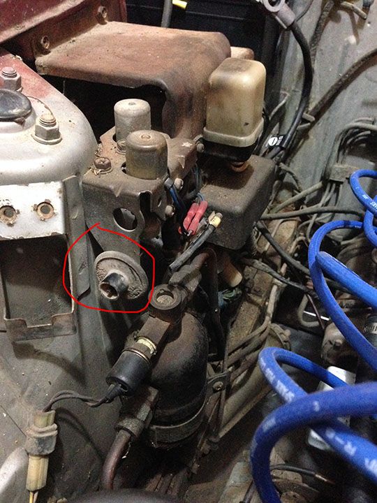

Spirit7 Posted February 2, 2014 Author Share Posted February 2, 2014 another question. what is this? The other end is connected to these tiny hoses here, but I'm not sure where they hook to. Quote Link to comment Share on other sites More sharing options...
Josh280z Posted February 2, 2014 Share Posted February 2, 2014 Those look AC related. Quote Link to comment Share on other sites More sharing options...
Spirit7 Posted February 3, 2014 Author Share Posted February 3, 2014 After some searching, it does appear to be related the the A/C system, I'm still doing some research to find out where exactly it is supposed to be routed. Quote Link to comment Share on other sites More sharing options...
NewZed Posted February 3, 2014 Share Posted February 3, 2014 It's a check valve for the vacuum reservoir. It's between the intake manifold and the vacuum tank so that your heater valves don't open and shut with the throttle opening and closing. There's a diagram in the usual place. Quote Link to comment Share on other sites More sharing options...
