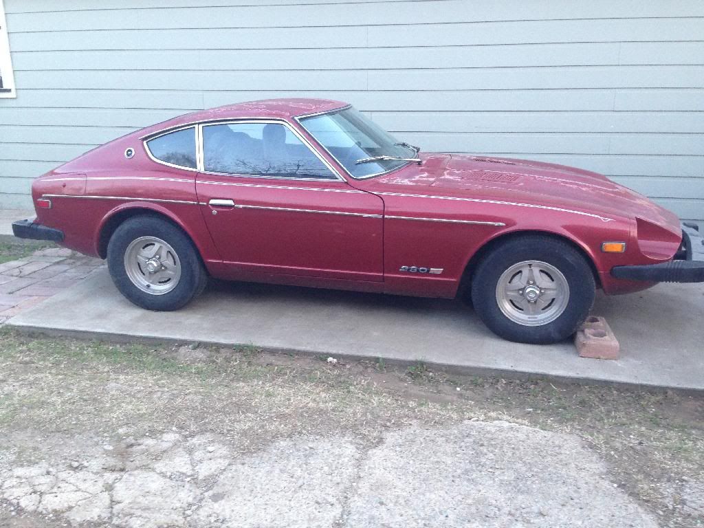

The_Rookie Posted February 17, 2014 Share Posted February 17, 2014 Got this as a project car and pretty much a first car. Quote Link to comment Share on other sites More sharing options...

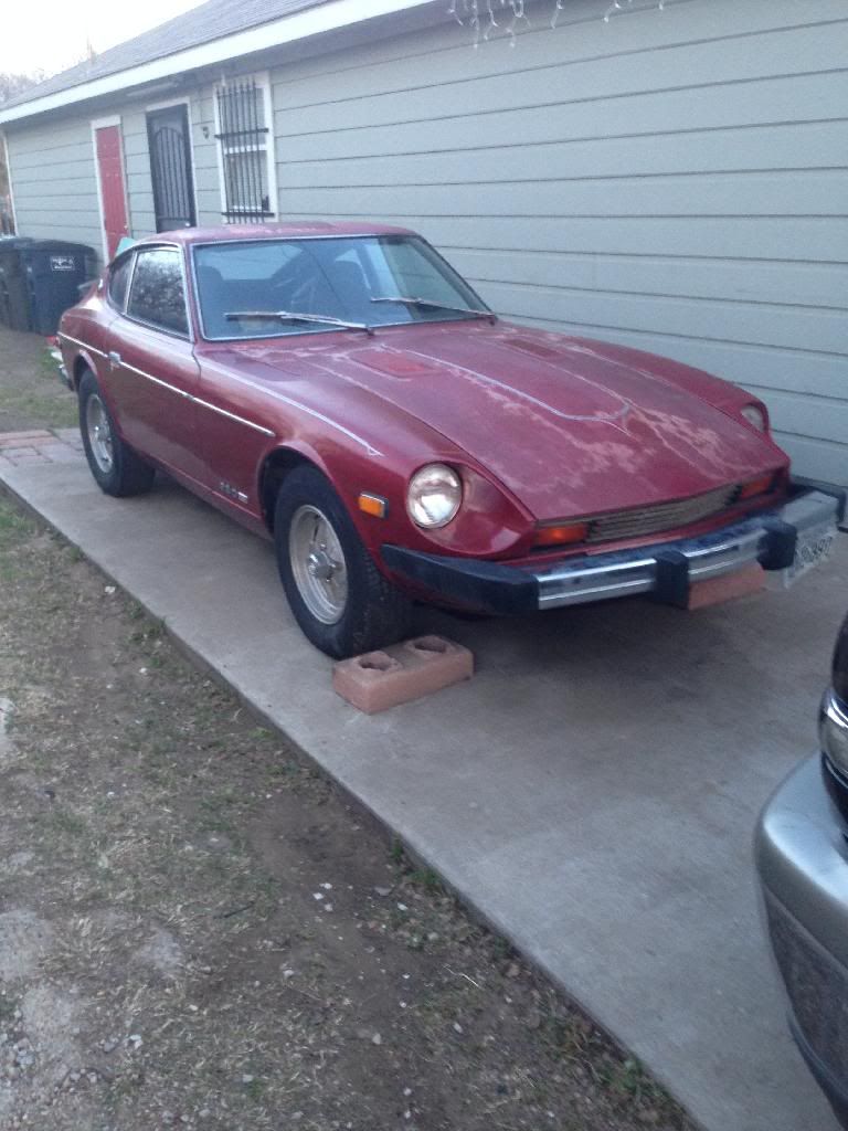

The_Rookie Posted February 17, 2014 Author Share Posted February 17, 2014 1977 280z that hasn't been running since 86. I don't think it'd be a good idea to try and crank the motor as is, what should I do? Quote Link to comment Share on other sites More sharing options...
BluDestiny Posted February 17, 2014 Share Posted February 17, 2014 Wait I thought you had a 280zx? and to get it running just check all the fluids, spray some oil in the spark plug holes and let it sit overnight, double check the wiring and it should start right up assuming the enigne isn't already fubar. Quote Link to comment Share on other sites More sharing options...
NewZed Posted February 17, 2014 Share Posted February 17, 2014 2014 - 1986 = 28 years. That is much longer than most "oil the cylinders and go" cars have sat. If the gas is gone, the residue is probably tarred up in all of the fuel system components. I would pop the valve cover and see how the cam looks, take the plugs out and make sure no cylinders are full of water, drain the oil and look for water, check the distributor cap, drain the fuel system and flush new gas through the lines, etc. Depending on the weather and where it was stored, water can build up in unexpected places. Check the fuel hoses also, my old EFI hoses split under the hose clamps and started squirting fuel after a few months of driving on a car that had sat for a while. You might have some work ahead of you. Quote Link to comment Share on other sites More sharing options...
The_Rookie Posted February 17, 2014 Author Share Posted February 17, 2014 I sold the Zx Blu. Thanks for the tips guys, sounds like I've got something to do this week! Btw, what's the best way to clean out the gas tank? Quote Link to comment Share on other sites More sharing options...
