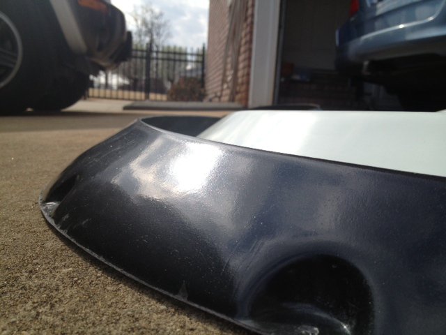

RebekahsZ Posted March 24, 2014 Share Posted March 24, 2014 (edited) I am learning about the various "ZG-style" fender flares out there on the market. So far, I have in my possession: Full set of fiberglass flares from RHDJapan. These are supposed to be the standard or narrow version. A pair of rear fiberglass "clone-ZG" (my terminology) fender flares from a US manufacturer out of California A pair of rear BAMF wide flares in carbon fiber from Z-Force ALL of these flares are incredibly thin material. These cannot be very tough or impact resistant. I consider them all to be trim accessories only. They are not tough like ABS or injection molded plastic. They are not tough like the production pieces you would find on a Chevy pickup or a Jeep CJ. None of them are pre-drilled. I guess it is on us to avoid cracking them when we "drill" them. Things I have noticed. The RHDJapan flare has the following features that distinguish it: 1. Smoother (more smooth?) finish. Made from random fiber fiberglass mat. I don't think I would bother with any prep prior to paint. 2. Flange on body side. This looks really nice. The other flares dig into the paint with a sharp edge. 3. Pretty roll or edge to the tire side-the others don't have this-it gives a nice "factory" look to the flare and probably makes it a little stronger. 4. Curve to follow body line. These are not straight where they meet the body. The fronts are very curved. 5. Off-white gel coat. 6. I have not fit these to a car, but I just sold them to a friend and I will get more feedback on the fit later. 7. These are marginally thicker material than the clones below. But not much; still very thin. The US "clone-ZG" flare 1. Rough finish, will need some filler to fill pin holes in gel coat prior to paint. Made from knitted fiberglass cloth. 2. No flanges, no roll, no curve to follow body line. 3. Surface cracks formed in gel coat when flexed to fit curve of body. 4. Very thin material.-like an egg shell. The Z-force Productions BAMF carbon fiber flare 1. Smooth, nice finish. Ready for clear coat with no sanding. Very pretty carbon fiber mat. 2. No flange, no roll, straight body edge. 3. With a little flexing (very little), these fit to the car without any cracks so far. 4. The thickest material of the three. Try not to reply to this thread yet, I will post pics in an edit later today/tonight. Then let the discussion fly. Edited March 25, 2014 by RebekahsZ Quote Link to comment Share on other sites More sharing options...

EF Ian Posted March 24, 2014 Share Posted March 24, 2014 RHD Japan sell both a set of thin ones (Race) and a set of thicker ones (Daily drivers) Your carbon ones are flat on the backside at the top? How well do they fit, they are meant to curve in a the backside top to follow the lines of the car. Quote Link to comment Share on other sites More sharing options...

RebekahsZ Posted March 25, 2014 Author Share Posted March 25, 2014 Pics are added to the original post. Let the flogging begin. I'm not going to argue on this thread. Anybody else can argue if they want, but not with me. I'm just going to post what I see from holding the actual parts in my hands. If you have something smart to say, say it with pictures that show your flares in a way that teaches something to someone considering buying a set of flares. Then we/they can make an educated purchase. That is all I seek - information. I do not desire a pissing contest with any one. And I don't know who manufactures anything. I just buy from folks who are selling. It is a shame that the folks who make things often don't sell them, because it makes it hard to track things down when problems arise. So unless the source sells them directly somewhere, I don't think it really matters who the source is. I think it is pointless to talk about flares that are no longer available, so lets not have a history lesson. I am happy to unsubscribe from this thread if it deteriorates into a chest beating match. Lets just help folks make informed purchasing decisions. Quote Link to comment Share on other sites More sharing options...
rturbo 930 Posted March 25, 2014 Share Posted March 25, 2014 ^ The RHDJapan flares are made by Marugen Shoukai http://www.rhdjapan.com/marugen-shoukai-wide-over-fenders-zg-wide-type-nissan-s30-s31.html Quote Link to comment Share on other sites More sharing options...

RebekahsZ Posted March 25, 2014 Author Share Posted March 25, 2014 I believe the white flares shown above are the Marugen Shoukai wide over fenders, RHD Japan product #68595. I am trying to get confirmation from the hybridsz member who sold them to me, and it seems I need to indicated if they are the racing version or the deluxe version. HS-30H, I see your point: RHD Japan also has similar looking flares made by Kameari over fenders. So I get your point about being more specific. There was no receipt in the box, so I will post it up as soon as he replies. Point taken. Quote Link to comment Share on other sites More sharing options...

RebekahsZ Posted March 25, 2014 Author Share Posted March 25, 2014 (edited) HD-30H - thanks for your contribution. I just would like this thread to be a place where folks can put pics of their flares to better understand what is out there and where to get it. I totally understand your points and I have followed a bunch of your posts over several years on the subject. I just don't want to be critical of what's out there. Lots of folks are OK with the "cheap" flares. If I bust a flare, which is a probability with as much jack-handle rash my car accumulates in any given year, I need to be prepared. It may be "worth" waiting a month or more for a replacement but I may not want to. For what it is worth, I have a set of Maugen Shoukai flares on-order right now. I'm also looking at interchangeability. The guy that I sold the Shoukai flares to found that either one or two holes were in a different location than on his cheap flares. That kinda sucks. I tried a set of cheap flares on my rears after I drilled the holes for my BAMF flares, and the drilled holes lines up well enough that I only had to enlarge a couple of holes a bit on the cheap ones. It is nice that RHD Japan tells us who actually makes these flares. I have not found US suppliers so forth-coming. Wonder why? Cause lots of cheap-skaters will try to go around them to try to get flares direct. This understandable lack of transparency makes it impossible to attribute each flare to its creator. Wish they signed their product like surfboard shapers do. Edited March 25, 2014 by RebekahsZ Quote Link to comment Share on other sites More sharing options...

osirus9 Posted March 26, 2014 Share Posted March 26, 2014 I've got a set of the marugen shoukai "street" flares, and I can say after fitting them to my car that they match the body contours on the front PERFECTLY. It is pretty much impossible to put the flare on the wrong side as they are contoured to the body very well, and they fit without bending once you figure out where the "sweet spot" is. The rears fit the body very well too, but the back of the car is flatter and you can kind of move them around a fair amount and still have them "fit". Mine are bent slightly in the rear to make the flares more circular and match the body contours more, although you certainly don't have to do that. I wish I had pictures, but my car is still at the body shop getting new paint/rust/dent removal. (since mid november....). Quote Link to comment Share on other sites More sharing options...

ECUAdam Posted April 1, 2014 Share Posted April 1, 2014 I would like to comment on the Marugen Shoukai flares that are purchased from RHDjapan. If you search this forum you will find a thread about a member that originally tried to start a group buy for the flares. In this thread he talks about language barriers and the difficulty he had in trying to find out the price. Then a person from rhdjapan stepped in and said he would deal with anyone from American that wanted to purchase the Marugen Shoukai flares. RebekahsZ was kind enough to let me purchase/ replace the Marugen Shoukai flares he bought from another forum member here. They are an exact copy of the flares you have pictured in your post HS30-H. They have defined curves in the flares to match the fenders perfectly. The quality is second to none in my opinion. I will go outside and get good photos with my camera and post back to this thread. They fit 10000000 times better than the copies I tried from another supplier. If you want something that is as good as zg flares then look no further. They cost more money than other copies, but sometimes you just have to pay to play. Fender flares are one of those times. Blown away by the difference. Quote Link to comment Share on other sites More sharing options...
