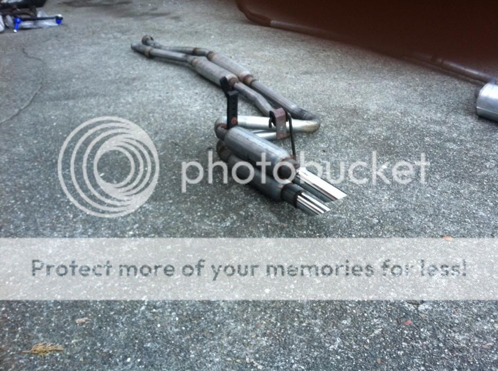

aprophet13 Posted August 1, 2014 Author Share Posted August 1, 2014 The exhaust took wayyy longer than expected but it came out sounding great and looks pretty sweet too. Its quiet-ish at idle and up to 3.5k but after that it gets pretty raspy and metallic. Its hard not to shift at 4k now haha Its 2.25" piping, no cat, no resonator, and then vertical glass packs with angle cut tips: Then I test fit the wheels: I could not have asked for better sizing on stock fenders. The wheel pokes an inch but since they're 15s its not too close to the fenders, and the 195s will tuck up nicely under the fenders and I might even get away with just a roll, no pull, and no added camber. This thing drives so great I really don't want to slam it, maybe fenders just below tire height, Idk we'll see how things progress.. Then came the spoiler/airdam. MSA Victory spoiler, and Urethane air dam. I didnt get any good pictures of the airdam since dinner pushed the install till after sun down so I'll get some better pictures with my friends camera of all the new parts. This is just a mock up on the jack and wood blocks: And this was in the parking lot at work: The new parts totally changed the feel of the car and I'm really liking the meaty sidewall look on 15's. I just got my pay check and am debating between coils or all the other susp. stuff like TC rods, LCAs, bushings, etc. Feel free to leave feedback! Quote Link to comment Share on other sites More sharing options...
Leon Posted August 1, 2014 Share Posted August 1, 2014 Did you have your exhaust done at Exhaust Works in Belmont? Looks just like the twice pipes that Todd built me a few years ago. Quote Link to comment Share on other sites More sharing options...
