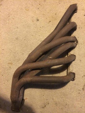

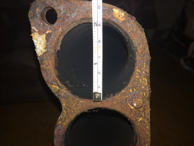

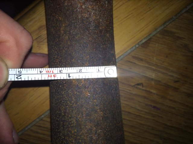

theczechone Posted June 26, 2014 Share Posted June 26, 2014 (edited) Trust header, about 35mm primary (OD) and dual 48mm outlets. Should be careful with the Japanese headers, some will not clear steering shaft on LHD cars. This one does thou Edited June 26, 2014 by theczechone Quote Link to comment Share on other sites More sharing options...
1vicissitude Posted July 25, 2014 Share Posted July 25, 2014 That trust header has surprisingly small primaries. Not sure I'd go that route on anything but a nearly stock motor. Quote Link to comment Share on other sites More sharing options...
