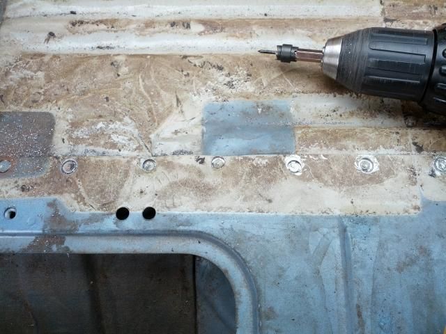

ls240z Posted August 2, 2014 Author Share Posted August 2, 2014 So I got started today, but the welds along the fender wells were proving to be a bitch. I'll have to cut some metal away with a reciprocating saw so I can get the drill in there. I'm heading to the lake for the long weekend so I'll finish up and update this thread on Tuesday or Wednesday. Quote Link to comment Share on other sites More sharing options...
ls240z Posted August 7, 2014 Author Share Posted August 7, 2014 So I got it all out and quickly gave the excess metal a little grind. Overall weight removed was 9.2lbs, so RebekahsZ, you were close. I'm sure if there were actual lids over the toolboxes it would be close to your 12 pound guess. Weight loss aside, I'm glad for the extra room. Quote Link to comment Share on other sites More sharing options...

RebekahsZ Posted August 8, 2014 Share Posted August 8, 2014 Maybe the other guy had 3# of dirt in the bottom! What did you use as your spot weld cutter (source and part number)? I need a lesson on that! Quote Link to comment Share on other sites More sharing options...
ls240z Posted August 9, 2014 Author Share Posted August 9, 2014 Haha, that could be true, I had a lot of hidden garbage in there. I bought them at our Canadian equivalent of Harbor Freight (Princess Auto). They cost me $10 for 2. If you plan on using them a lot, get a good quality set. Mine dulled quickly because they are crap, but they did the job and I won't need them again. Here's a link to what I used: http://www.princessauto.com/pal/en/Drill-Bits/2-pc-Spot-Weld-Cutters/3410034.p Quote Link to comment Share on other sites More sharing options...
