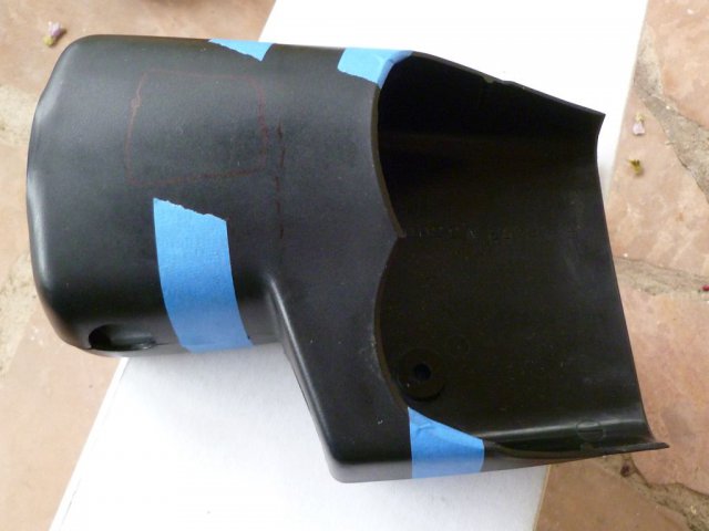

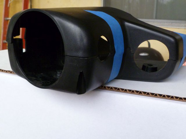

OldAndyAndTheSea Posted December 5, 2014 Share Posted December 5, 2014 (edited) Well I did some homework today. I have a 260z, and I remembered I had a clamshell from it. Can anyone confirm if the clamshell used in the 260z is the same as the 280? And does the early/late version matter. Mine is an earlier 260. Here are my specimens. (240 left, early 260 right) Both fit the 240z steering column. I think the later style clamshell would be optimal for a gauge provision, since it has a flatter portion on the top. (Plus my 260 shell looks to be in salvageable shape) Here is the 260 clamshell on the 240. Gorilla tape mocked. Running wires won't be too hard, but what's going to be a PAIN is figuring a way to make them attach, and close again. I doubt I'll be able to recreate the OEM fastener system. And yeah, 2 1/16" gauge pod would be secondary bonded somewhere around here, me thinks. Edited December 5, 2014 by OldAndyAndTheSea Quote Link to comment Share on other sites More sharing options...
LanceVance Posted December 5, 2014 Share Posted December 5, 2014 The 260 version looks to be the same as mine (75' 280). Quote Link to comment Share on other sites More sharing options...
