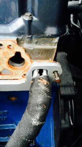

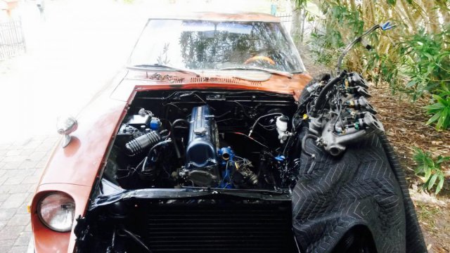

Project1 Posted February 24, 2015 Author Share Posted February 24, 2015 Got to work on the Z this week, I made some progress but ended in a stand still. Note to self ... Don't order a abarth exhaust for a datsun. The motor went in well and things are looking ok. I did put a hole in the header. The "new" header I got of ebay was a rusted out pos. so I'm just going to order a msa one and go from there. I will weld this one up and just sell it to someone local for really cheap. So waiting on a new header. Quote Link to comment Share on other sites More sharing options...

Project1 Posted February 25, 2015 Author Share Posted February 25, 2015 (edited) Wow, sucks about that header, it's pretty low that someone would try to pass that off as new.Right, :-/ ... I guess you win some/loose some. I do hope this motor runs ok, I'm keeping my fingers crossed. I just got them painted, wraped up and a flange with a bung for a wide band too ..gezzz. I got them for $200 so I guess you get what you pay for sometimes. They had the emission ports, but I just pluged them with some copper blots... But ..well ..you see ..merrr. Edited May 19, 2015 by Project1 Quote Link to comment Share on other sites More sharing options...
Tony D Posted February 26, 2015 Share Posted February 26, 2015 That header with the wrapping on it that is 'rusted' isn't the same one in the other photos with the AIR Injection fittings on it.I haven't seen a header with AIR on it since the 80's. Once they started those CARB EO program the supply stopped and they just started 'not to be use on highway vehicles' statements. Quote Link to comment Share on other sites More sharing options...
Project1 Posted February 26, 2015 Author Share Posted February 26, 2015 That header with the wrapping on it that is 'rusted' isn't the same one in the other photos with the AIR Injection fittings on it. I haven't seen a header with AIR on it since the 80's. Once they started those CARB EO program the supply stopped and they just started 'not to be use on highway vehicles' statements. It's the same header, I just painted and wraped it. I thought thoes were something for emissions? I honestly have never heard of air injection into the exhaust (or is it to inject exhaust air into something like an erg?) Quote Link to comment Share on other sites More sharing options...
Tony D Posted February 27, 2015 Share Posted February 27, 2015 Did you remove the threaded tubes? it looks in the photo like they were removed.Yes, that is an OLD header, intended for up to a 74 Z-Car. There was a small pump on the left side of the engine that pumped air into the exhaust there to combust the unburned HC. It was quite effective, just one injector into the collector of that header would clean up a 71 with SU's properly adjusted to 83 Catalyzed SMOG Criteria. It started in 66 in California, and went on quite late in Domestic stuff...Frankly, if it's an EFI engine, you don't need them, you don't want them...you are better off getting something newer like you say--it will be better all around. For someone wanting to make a 'period correct' restomod it might have a place in someone's car! Quote Link to comment Share on other sites More sharing options...
Project1 Posted February 28, 2015 Author Share Posted February 28, 2015 Did you remove the threaded tubes? it looks in the photo like they were removed. Yes, that is an OLD header, intended for up to a 74 Z-Car. There was a small pump on the left side of the engine that pumped air into the exhaust there to combust the unburned HC. It was quite effective, just one injector into the collector of that header would clean up a 71 with SU's properly adjusted to 83 Catalyzed SMOG Criteria. It started in 66 in California, and went on quite late in Domestic stuff... Frankly, if it's an EFI engine, you don't need them, you don't want them...you are better off getting something newer like you say--it will be better all around. For someone wanting to make a 'period correct' restomod it might have a place in someone's car! Awesome, I did not know that. I was just going to plug the holes with a bolt and some hi heat rtv on the threads. I did remove it, just not intentionally ...it broke off and left that nice hole you can see in the pic. I am going to get some new headers for sure. I might run these just for a bit just for budget reasons. But I will probably put that extra motor n42 on craigslist with the header and exhaust and just sell everything for a fair price. Quote Link to comment Share on other sites More sharing options...
Tony D Posted March 2, 2015 Share Posted March 2, 2015 How do you plan to plug that gaping hole??? That's what I thought it looked like, BTW. Once the AIR tubes left the cast iron manifold and got put into headers, ripping them out when the thin tubular headers rusted away due to the heat was quite common. You just tossed them and got another set, along with a new AIR Tube set from Nissan (when they were still available!) I think I actually have one of those in my shed, AIR Gallery still attached for fear of the "tear out" from rushing it's removal. Quote Link to comment Share on other sites More sharing options...
Project1 Posted March 3, 2015 Author Share Posted March 3, 2015 How do you plan to plug that gaping hole??? That's what I thought it looked like, BTW. Once the AIR tubes left the cast iron manifold and got put into headers, ripping them out when the thin tubular headers rusted away due to the heat was quite common. You just tossed them and got another set, along with a new AIR Tube set from Nissan (when they were still available!) I think I actually have one of those in my shed, AIR Gallery still attached for fear of the "tear out" from rushing it's removal. Seriously, that thing broke off so easy..... Aka "vintage". I could weld a patch over it, however it maybe difficult to get it to an actual clean surface. I might be better off just using some jb weld or something. Quote Link to comment Share on other sites More sharing options...
Tony D Posted March 3, 2015 Share Posted March 3, 2015 Personally I'd trash the header...with that wrap...it's not long for the world! Hotspot burnthrough is right around the corner! Quote Link to comment Share on other sites More sharing options...
Project1 Posted March 4, 2015 Author Share Posted March 4, 2015 Personally I'd trash the header...with that wrap...it's not long for the world! Hotspot burnthrough is right around the corner! I just couldn't help laugh when I read that ... Something too look foward too. I did patch a very small hole in the radiator as well. I have some unexpected financial obligations, so I am going to run them for a short bit, and as soon as I can the first thing on the list is a new header and radiator. ... ... ... $@%^ing hotsots. I'm cracking up and frowning at the same time. Quote Link to comment Share on other sites More sharing options...
Project1 Posted March 9, 2015 Author Share Posted March 9, 2015 (edited) Got to work on the datsun today. The mystery motor is almost ready to crank. I just have to replace some fuel line, put together the vacume system, and do the ignition. The N42 is 98% done. Came out pretty good. I would have like to do some head work and some flat tops, but since it's an extra motor it's really not worh it and I'll probably never get my money back so I'll leave it for the next guy. Here's some pics of the N24. I'll take some pics this week of the other motor. I'll see if I can do a video to hear how the abarth sounds. There really isn't too much online ... Although it's a 1.75 rusty @$$ pipe, so I wouldn't recommend it. Edited May 19, 2015 by Project1 Quote Link to comment Share on other sites More sharing options...
