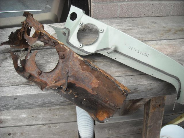

jdmjunkies.ch Posted November 23, 2016 Author Share Posted November 23, 2016 Lately i really appreciate the updates from the bodyshop. And If things go right i will visit him and my car again on monday. However here are the latest pictures i got What you see here is the inner rear right quarter panel piecte between the trunk floor and the Fender. it contins the hole where the fuel filler hose goes through. As you can see the original pieces was totally rusted and he created a new one from scratch: Here it's installed test-wise: View from the outside: View from the bottom. As usual: Work of art. May look a bit rough now, but once it has some primer on it it will be like it was from factory Quote Link to comment Share on other sites More sharing options...

grannyknot Posted November 23, 2016 Share Posted November 23, 2016 Just for reference, here is that same panel NOS from Nissan, looks like your guy nailed it. Quote Link to comment Share on other sites More sharing options...
jdmjunkies.ch Posted November 25, 2016 Author Share Posted November 25, 2016 Just for reference, here is that same panel NOS from Nissan, looks like your guy nailed it. DSCN0413.JPGDSCN0414.JPG Whoa, that looks indeed like he built a perfect panel. thanks for the reference pix. awesome Quote Link to comment Share on other sites More sharing options...
