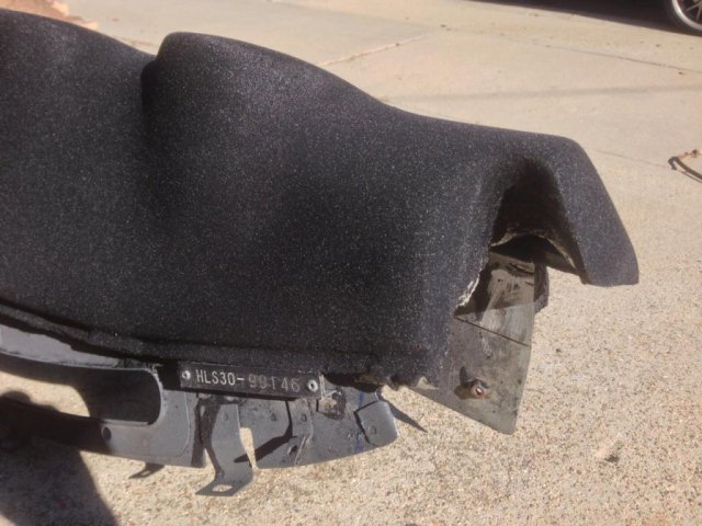

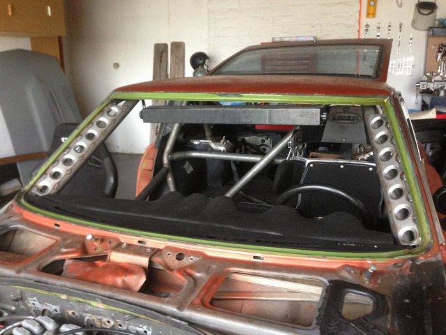

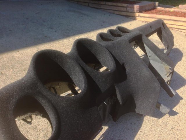

fyanrudger Posted February 5, 2015 Share Posted February 5, 2015 (edited) Another option is flocking. Suede-ish appearance/feel. No glare. Relatively simple to do. Had mine done for two years and it held up fine. Recently redid it because of the cage. Edited February 5, 2015 by fyanrudger Quote Link to comment Share on other sites More sharing options...
thedarkie Posted February 7, 2015 Share Posted February 7, 2015 ^^ That looks cool, got in-car shots? Quote Link to comment Share on other sites More sharing options...
fyanrudger Posted February 7, 2015 Share Posted February 7, 2015 (edited) Surprisingly, I can't find any good ones. Hopefully the dash will be going back in early next week... Oh, and of course, you can flock your center console to match. Edited February 7, 2015 by fyanrudger Quote Link to comment Share on other sites More sharing options...
fyanrudger Posted March 28, 2015 Share Posted March 28, 2015 Not a week. Dash is pretty dust-covered, but it's back in for a bit. Quote Link to comment Share on other sites More sharing options...
