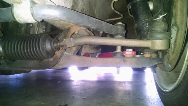

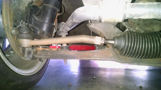

New-to-240z Posted February 1, 2015 Author Share Posted February 1, 2015 A little off topic, but do you think that this picture shows that I need bump steer spacers? From the looks of the tie rods, I do, but a second opinion is always welcome . . @Rebek: I'll post a walk through once I think about all the steps I'm not the smartest guy, so hopefully someone can poke holes and offer some constructive criticism on my process. Quote Link to comment Share on other sites More sharing options...
johnc Posted February 1, 2015 Share Posted February 1, 2015 FYI... You are not going to get the alignment right the first time. You have to do a few test sessions and take tire temps to find out what's right for you and your car. You will also adjust the alignment between sessions to better suit the track and the conditions. That's normal. I suggest you have a marked setting for the street alignment only. And for toe adjustment, you don't mark anything, you count turns. Quote Link to comment Share on other sites More sharing options...
johnc Posted February 1, 2015 Share Posted February 1, 2015 And your picture above shows the car is to low in front, raise it, add a bumpsteer spacer, or relocate the inner LCA mounting point. Also, you ARB end link bolt is in upside down and trim the tie Rod End cotter pin or you'll scratch the shIt out of your hands. And you've tightened down the end links too much. Don't squish the bushings. Just snug it down. Quote Link to comment Share on other sites More sharing options...

New-to-240z Posted February 4, 2015 Author Share Posted February 4, 2015 (edited) @JohnC: I'll mark adjustment points for the 'standard' driving position and of course number of turns as well. - I'll flip the ARB end bolts and snug them down this time (may have to buy new bushings since they have always been this deformed since install. Amazed no-one has noticed this with all the alignments). - The car is at the perfect ride height for what I am looking for, so I'll purchase the bumpsteer spacers from MSA the next time I'm there and install those and see what difference that makes. Hopefully it will be enough to correct the angle. I've read that people needed to take some material off the BS spacers, is that the case with the MSA ones or is that only Arizona Z? @Aongch: My feeling was to have a standard alignment done and then another using JohnC's. Then, getting everything tested and figured out. Then finally move to corner balancing and getting it dialed in exactly. (this may not be the right order. I may want to corner balance first, but I would think that I would want my exact alignment settings before corner balancing.) Thank you EVERYONE for all the help. Once this is all put back together on the Z, I'll be taking her out to the track and having some fun learning! (On a side note, I've also read that the 8KG front and 6KG rear is too stiff for our cars. I have the ability to grab some Swift springs and was thinking of going 6KG front, and 4 or 5 KG rear. This would allow for a little extra give, but that's just me looking over numbers and other people's setup and company's products [Arizona Z] ). Should I leave the 8kg and 6kg springs in for now or switch to the softer springs since everything is out of the car and not aligned yet?) Edited February 4, 2015 by New-to-240z Quote Link to comment Share on other sites More sharing options...
RebekahsZ Posted February 5, 2015 Share Posted February 5, 2015 With just 15" wheels, and bumpsteer spacers, the grease zerks in the outer tie rod ends, and the tie rod ends themselves can rub on the inside of the wheels. Removal of the grease zerks (install a little plug) and a little grinding on the tie rod will fix this. Going to 16s or 17s makes the problem go away. Think about making some blocks (even wood can work) to space the swaybar away from the frame a half inch to keep it from binding on the body. You can just use longer bolts that pass thru the sway bar bracket and the spacer. Quote Link to comment Share on other sites More sharing options...
