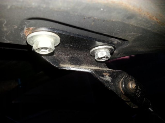

RB26240Z Posted February 26, 2015 Share Posted February 26, 2015 Does anyone know where I can find the bracket that is attached to the deck lid where the strut mounts? Quote Link to comment Share on other sites More sharing options...

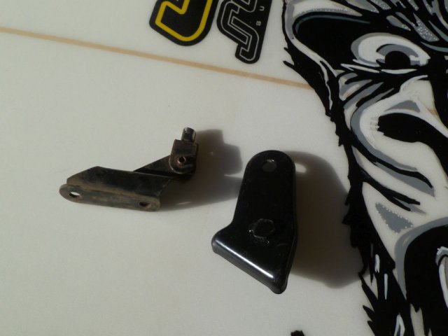

88dangerdan Posted February 27, 2015 Share Posted February 27, 2015 If you're talking about these I believe I may have a couple. They're attached to the struts Let me know Daniel Quote Link to comment Share on other sites More sharing options...
Nelsonian Posted February 27, 2015 Share Posted February 27, 2015 Would you be referring to the bracket on the right or left in the provided picture? Quote Link to comment Share on other sites More sharing options...
Nelsonian Posted February 27, 2015 Share Posted February 27, 2015 I suppose it would help if I attach the pic. Quote Link to comment Share on other sites More sharing options...

djwarner Posted March 1, 2015 Share Posted March 1, 2015 Jay, your 71 came with a single bracket that was spotwelded to the hatch frame. Over time the stress from the strut flexes the welds and causes them to fail. The fix involves filling through holes in the frame and bracket and securing with screws and bolts. I may have a spare one in the garage. You can get a new strut at autozone. There is a second bracket to secure the other end of the strut to the hatch near the lower cover. Do you need that one as well? Quote Link to comment Share on other sites More sharing options...
djwarner Posted March 1, 2015 Share Posted March 1, 2015 Oops,... Drilling - not filling. Curse you auto correct. Quote Link to comment Share on other sites More sharing options...
