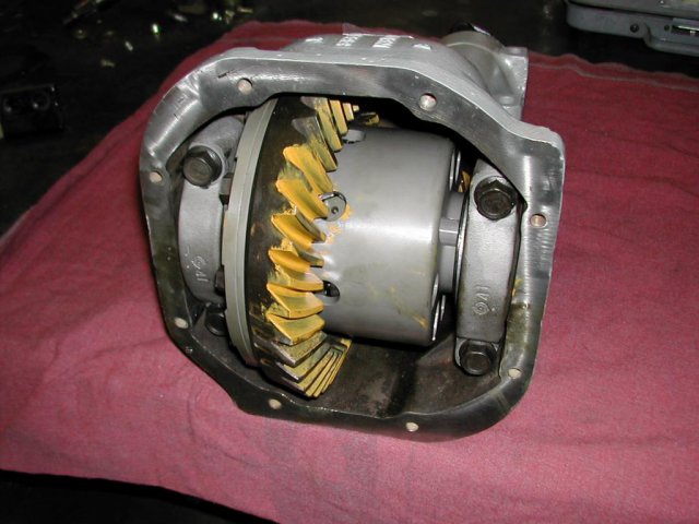

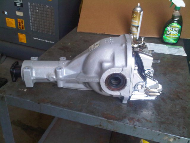

alainburon Posted March 11, 2015 Share Posted March 11, 2015 I have the OS Giken Superlock in my longnose R200. I had Beta Motorsports build it for me with all new bearings and seals. I don't know much about how it was put together. John Coffey may be the person to ask about this set up as he was the one who built it for me. I was told those locker units are really strong. It looks like we are running similar set ups. Same transmission, similar hp motors, silmilar suspension and brakes. Can't wait to see it come together. Quote Link to comment Share on other sites More sharing options...

johnc Posted March 11, 2015 Share Posted March 11, 2015 Any competent diff shop can set it up. If your ring gear used the 10mm bolts then you must use bushings to make up the difference between the 10mm OD of the bolt and the 12mm ID of the holes on the OSG Superlock flange. If a diff shop is telling you the bushings are not needed they are being lazy or cheap. These are then exact bushings in Alain's diff.http://asbbearingsonline.com/index.php?main_page=product_info&cPath=86&products_id=3449 Note: I posted the wrong link a minute ago. Correct link above (10mm ID, 12mmOD, 10mm height). Quote Link to comment Share on other sites More sharing options...
