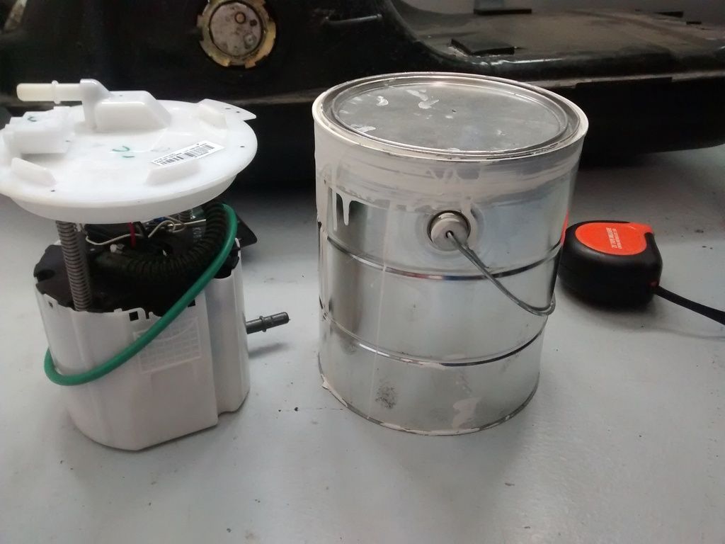

Yeahhhh what happens to cost next to nothing, is made of steel, fits a camaro sending unit in it and reduces welding by 90%? Yep paint bucket. Gona drill out the bottom with a hole saw (a new paint can of course), and cut to the desired height, now if only it had a lip on the top... another fun fact there are 1 gallon cups out there that do! I may look into one of those as well

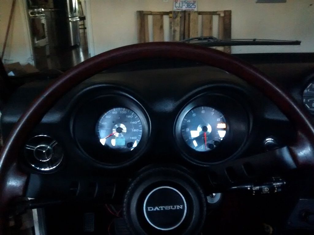

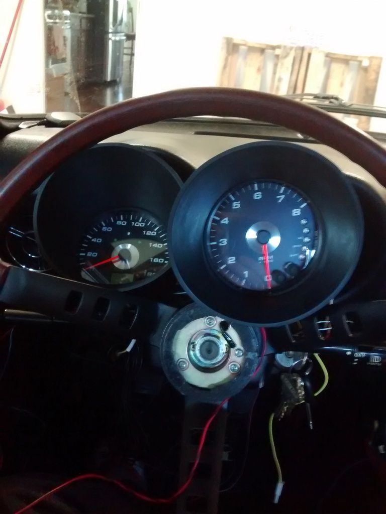

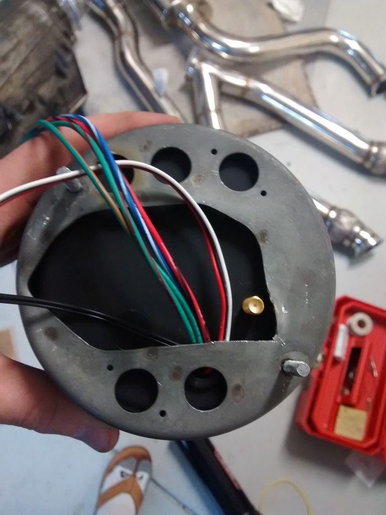

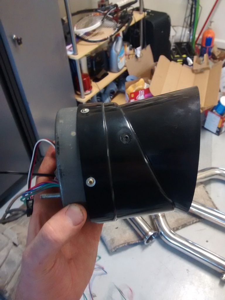

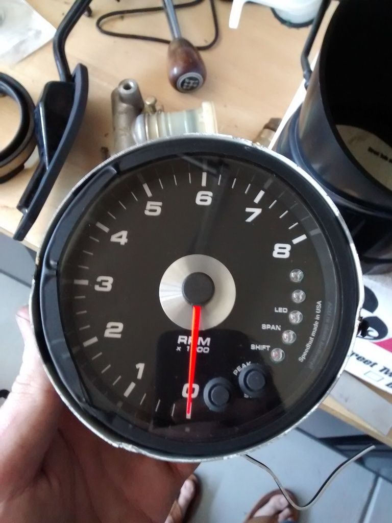

Driveshaft came in, also got Speedhut speedometer and tachometer in. I got the 4.5" gauges on a hunch they would fit perfect, and guess what they do! I removed the old gauges from the buckets, removed the bezel from the speedhuts, put electrical tape around them to keep the glass on, removed the old datsun glass, and they slid right in. The wingnuts were a giant pain in the ass to get off, had to squeeze a pliers in to get at them, and then the speedo had one nut that wouldnt budge. Once I got the tach off I was able to slip in a socket wrench with a 3/4" socket, fits right on the wingnut.

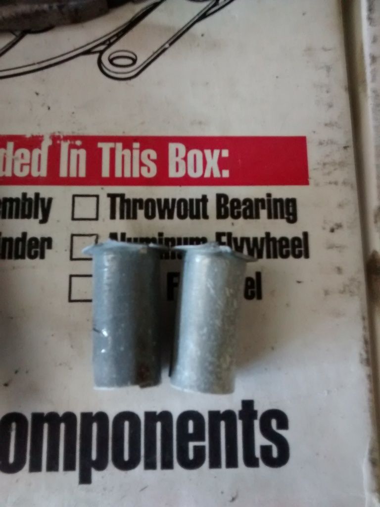

Had to pull these tubes out, just grab them and wiggle with pliers till they break
Had to knock out the back of the speed and cut a little tab for the GPS screw:
It fits!:
Wiring them up
All done

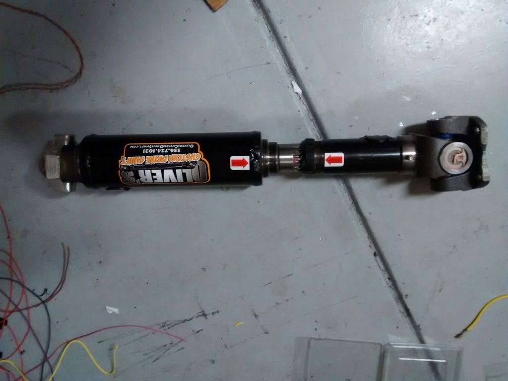

And the driveshaft to soon go in

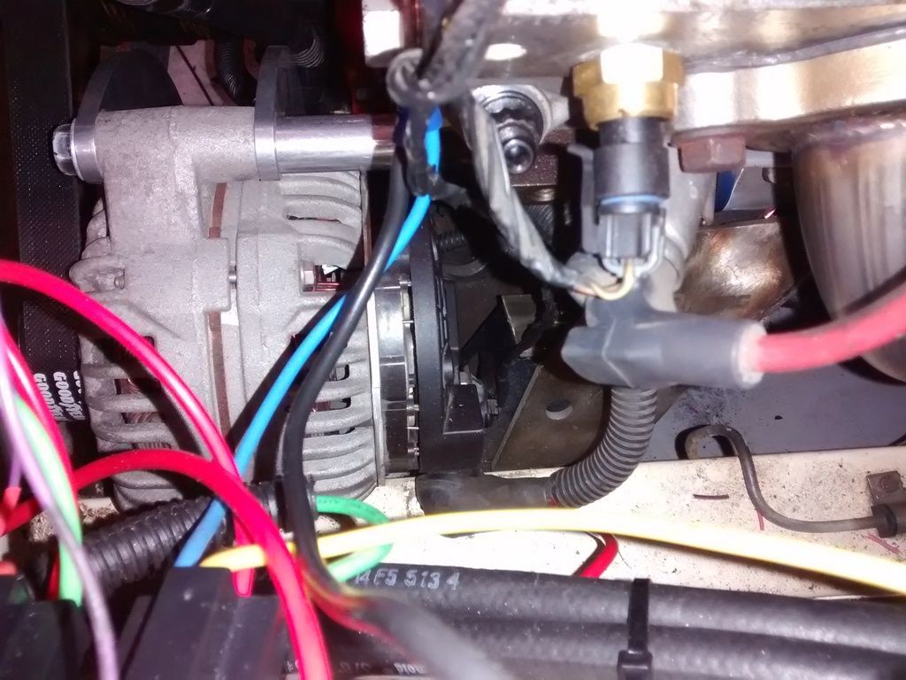

The issue with the mounts is the depth. The compressor back will extend into the motor mount, for reference the back of the alternator on the driver side is almost touching the mount:
I think that the alternator may need to be clearancing using the fbody accessories since the truck actually spaces it forward a bit.

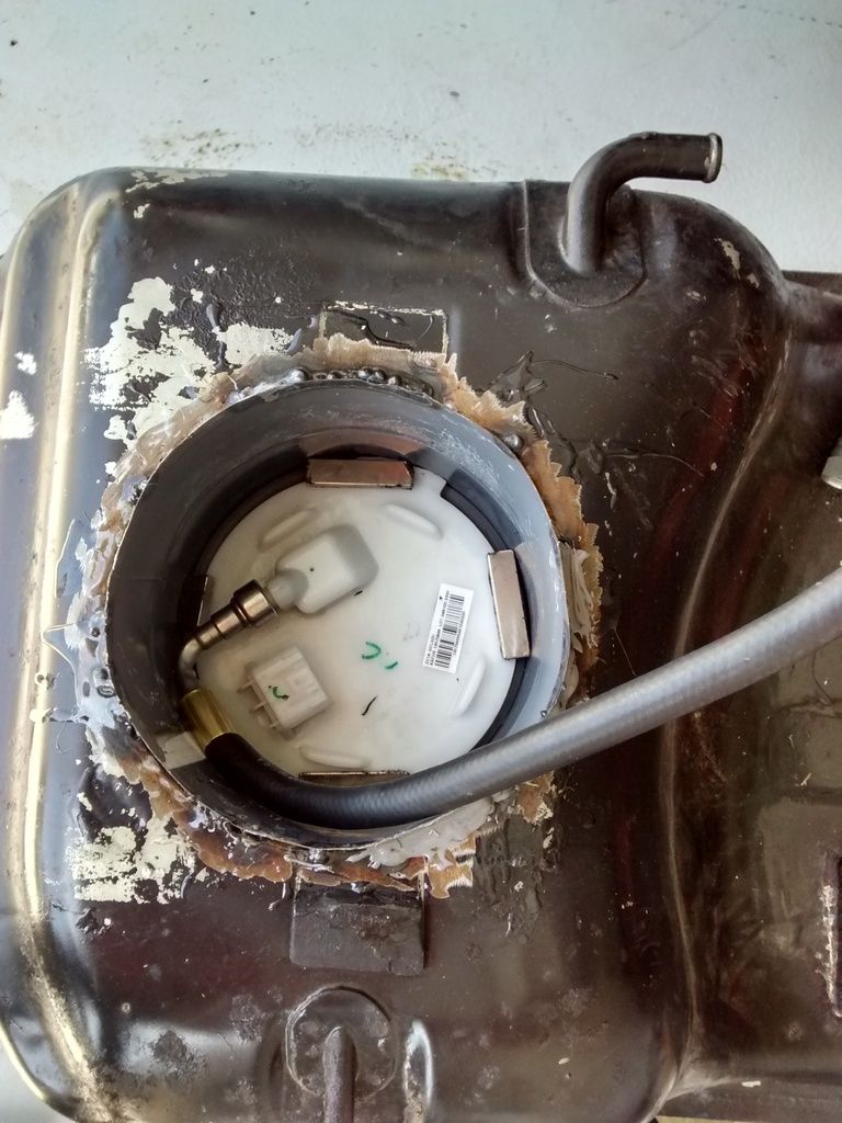

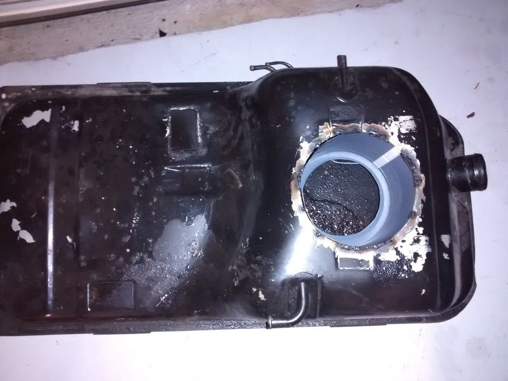

Here is the gas tank with the paint can in it, the metal is very thin on the can, if I had noticed sooner I would have looked for something else. Only placed a number of tacks on it because it was burning through jb welded the rest later. About to go pick up the fuel lines then I will hook it all up. One issue with the paint can is that it is not the optimal diameter for the big 5th gen sending unit, it doesn't give much space to weld on a hold down ring. I bought some real strong bar magnets which I am using 8 of to hold the sending unit on (each has 26lb holding force) when tested for leaks it didn't.
Shifter is in, tranny is almost in, have to drill two holes to mount the crossmember and it is very hard to get a drill in there. I picked up a 1 foot drill extension which should allow me to get in there. Driveshaft is in too.

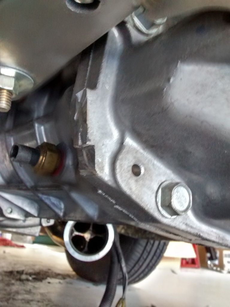

Car came to life today, briefly... Need to investigate the computer and the grounds. If I turn the key from off to crank it fires off right away but for only a second. If I keep the key on ON and try to crank it never fires off. Not sure what is up but will check the tune. Noticed that the power to everything else was getting cut during start, tied together some old coil wires to fix that at least for the ECM stuff. The y-pipe was a pain to get on, had to trim this corner off the TR6060 to get it to fit:

Here's the sending unit all jb welded and looking like crap in the tank, but it works good:
IMG_20150514_121501365_HDR_zpsnsh8ayc7.j
Be cautious, JB weld dissolves after contact with gasoline for a while. I tired to seal a leak at my sending unit with it, it turned gummy and started leaking with in a week.
Use fuel safe epoxy if welding isn't possible.
Congrats on progress! Any reason you went 5th Gen pump/pickup versus 4th gen? I like the idea, kills a couple birds with one stone and eliminates the pump whine :)
Well I had heard people were shifting to the fifth gen units, the guy that sold me the LS3 intake had the whole sending unit cheap so I grabbed it. Looking back the 4th gen would have been much better.
Well that is not what I was hoping to hear :o the packaging said "resistant to all fuels and petroleum products" maybe it was a different formula?
Man I hope not, that's why I bought the kit.... To use the stock fbody low mount alternator. When I spoke to tech at CXRacing they said it was designed to work..... Guess we will find out when I try to pop her in. No AC for me. My car will be more track oriented
