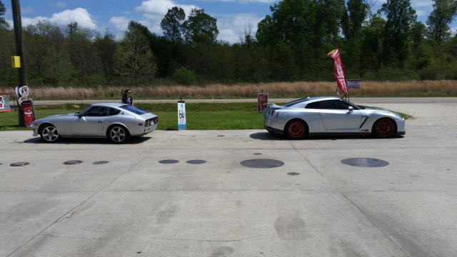

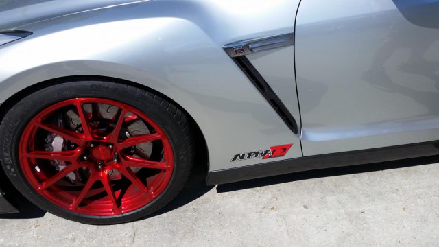

socorob Posted March 30, 2015 Author Share Posted March 30, 2015 I went on a few hours car drive today with a group of about 20 cars. Only 1 other Datsun , which is pictured below, some kind of special crazy high hp car. Anyway the vibration was irritating my wife which in turn made to be sure to REALLY irritate me about the car shaking, so I really need to try to solve this. Quote Link to comment Share on other sites More sharing options...
