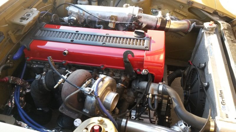

Drift Boss Posted February 5, 2016 Author Share Posted February 5, 2016 I painted my valve covers *was painting a car, and had some left over materials. Quote Link to comment Share on other sites More sharing options...
Exposed Posted February 5, 2016 Share Posted February 5, 2016 valve covers came out great. What type of emu are you running? Quote Link to comment Share on other sites More sharing options...
Nelsonian Posted February 5, 2016 Share Posted February 5, 2016 I am interested in that Griffin radiator. Is that a 26"x19" core ? Quote Link to comment Share on other sites More sharing options...

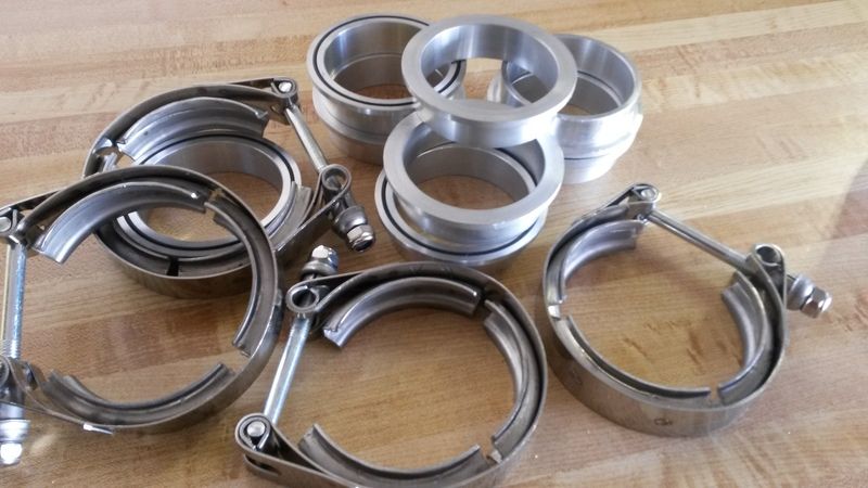

Drift Boss Posted February 6, 2016 Author Share Posted February 6, 2016 I will have to measure it again. You're not the only one that asks that lol. As of right now, no tune. Garrett gt40 on 10psi, seems to be doing fine, but I do not get on it. Waiting for a buddy in Japan to source me a Apexi power fc. Ideally I would want aem, or ecu masters stand alone...but you know, limited only by money. Anyway, here is my couplers. =) Next parts I am getting is Id1000 injectors Aeromotive fpr Bigger fuel lines 2x DW 350 inline fuel pumps 1x daul fuel pump holder Fuel rail with an fitting welded in middle And...a apexi pfc. Should wake up this old 1jzgte. =) Quote Link to comment Share on other sites More sharing options...
Drift Boss Posted February 6, 2016 Author Share Posted February 6, 2016 It's going off to a shop to get the piping made and the vband couplers welded on. Over kill? Quote Link to comment Share on other sites More sharing options...
Exposed Posted February 8, 2016 Share Posted February 8, 2016 not at all, cant wait to see more progress pictures. Quote Link to comment Share on other sites More sharing options...

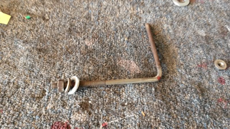

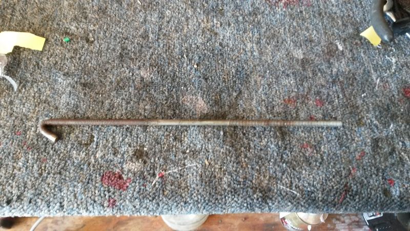

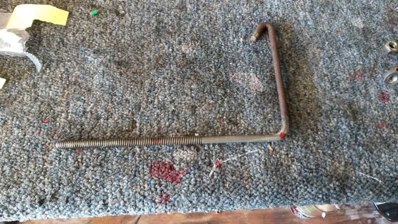

Drift Boss Posted February 11, 2016 Author Share Posted February 11, 2016 Battery hold down? Quote Link to comment Share on other sites More sharing options...

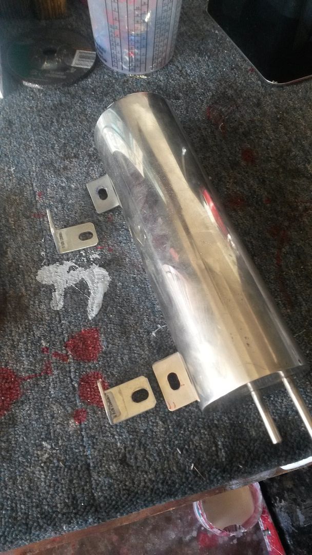

Drift Boss Posted February 11, 2016 Author Share Posted February 11, 2016 Finally have a overflow (going to weld a piece to make it a "T") Quote Link to comment Share on other sites More sharing options...

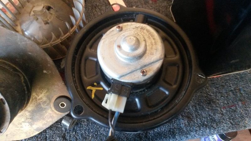

Drift Boss Posted February 11, 2016 Author Share Posted February 11, 2016 Honda civic 89 to 91 or whatever they stopped making the ef chassis. *it is not a bolt in deal! Requires trimming the Datsun blower housing. After triming, the bolt holes DO line up, and you can use the own Honda rubber! Love how much air it flows and how quite it is. Quote Link to comment Share on other sites More sharing options...

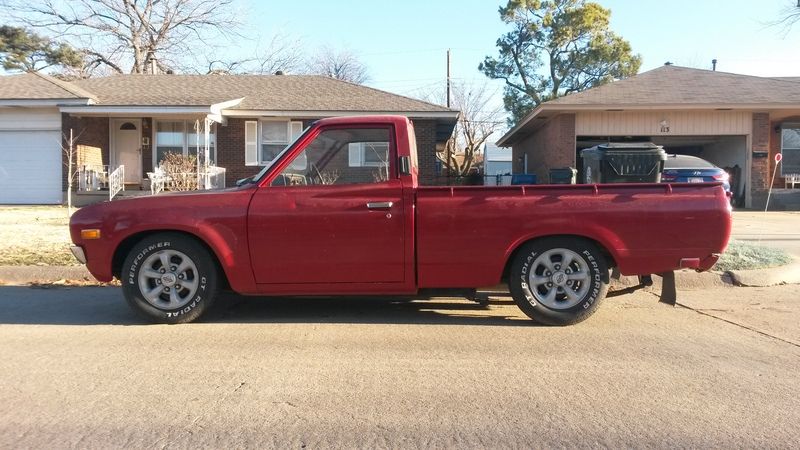

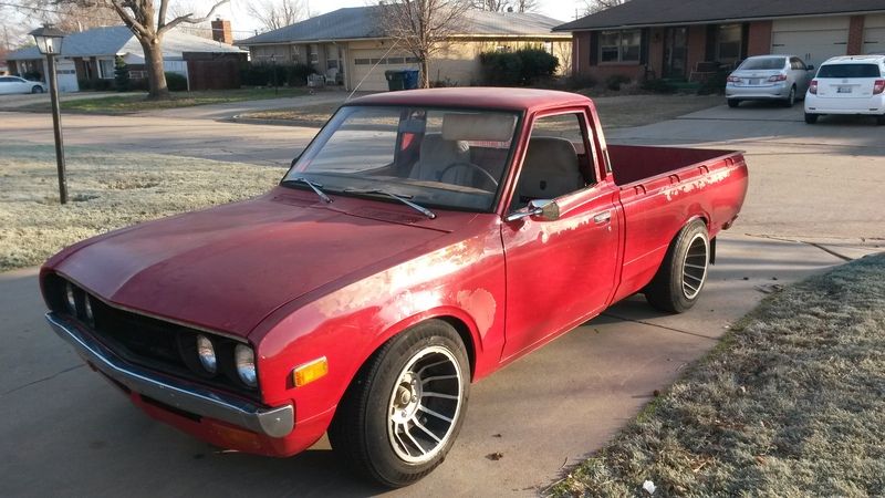

Drift Boss Posted February 18, 2016 Author Share Posted February 18, 2016 Oh, I bought a Datsun 620! You know...can't help but to modify it. Lowered on blocks, and re angled torsion bars. With some frontier wheels. (Do have flares, wheels, mirrors, and some paint coming) Quote Link to comment Share on other sites More sharing options...

Drift Boss Posted February 23, 2016 Author Share Posted February 23, 2016 Quote Link to comment Share on other sites More sharing options...
Exposed Posted February 23, 2016 Share Posted February 23, 2016 truck looks great, what are your plans for it? Quote Link to comment Share on other sites More sharing options...
