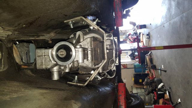

Fullauto Posted August 29, 2015 Share Posted August 29, 2015 Was first a San Diego car was basically all original till now. 90,000 miles. 2nd owner since 1987. In storage for 20 years. Drove it around stock for a while. Good shape minimul rust, no cracked dash. This web site is why I decided to do this, you guys are amazingly talented in this v8 forum. Slowly making progress with the cx racing mounts and headers with v pipe only. R200 3.92 gears OS giken LSD built by Unitrax, I used Techno Toy rear arms when I put the diff back in. Lowered about 1.5 inches. Hope to test fit the ls1/t56 soon. Hopefully goes as well as trackzpeeds!! Thanks to all for the incredible builds and advice. Here are a few pix. Quote Link to comment Share on other sites More sharing options...

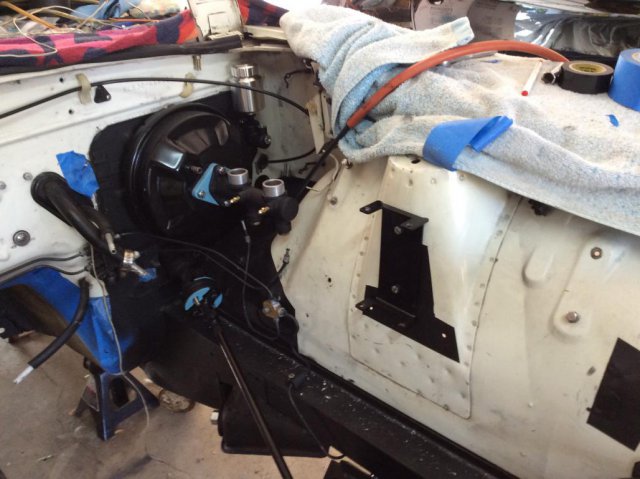

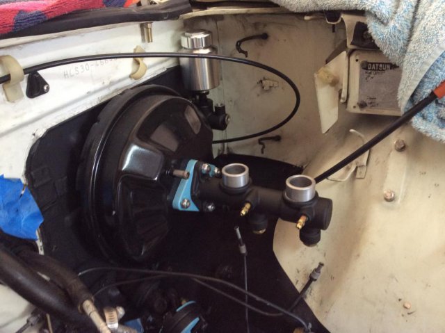

Fullauto Posted September 2, 2015 Author Share Posted September 2, 2015 Got the t56 tail modified so i can run the stock speedometer. Putting the McLeod RST with aluminum flywheel on today. I think Im getting a handle on the wiring... I dont think I even need the stock pcm for anything. Just keeping the oil sender for stock guage and same with water temp(moded like Domz suggested) Need the tach modified for v8. Upgraded the brake booster and master to the zx. Tilton 7/8 clutch master, with the remote bleed per advice here (rebeccasz) Only a million thing to go...... Quote Link to comment Share on other sites More sharing options...

Fullauto Posted September 25, 2015 Author Share Posted September 25, 2015 Tilton clutch with wilwood res Zx booster Puttin coils on the strut towers Waitin on mgw shifter Finally cooling off a little here in Austin!!!! Just completely rebuilt front suspension on the sc430 so now back to the Z car.....its always some kinda distraction...lol Quote Link to comment Share on other sites More sharing options...

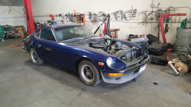

memosauto44 Posted September 25, 2015 Share Posted September 25, 2015 71 240 5.3 t56 swap Quote Link to comment Share on other sites More sharing options...
Fullauto Posted September 25, 2015 Author Share Posted September 25, 2015 Nice car!!! Looks like you have a great place To work on car. I like those wheels!! You gonna have it runnin soon? Nice job! Quote Link to comment Share on other sites More sharing options...
