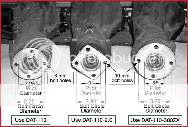

1975 280Z's have the oddball R200 pinion flange.  It has its own unique bolt pattern and bolt size (might be the same as the 300ZX's, not positive.  Definitely not like the other Z cars though).  So if you cut a 1975 R200 driveshaft, it's only good for 1975 R200's.  Beware the 1975 R200.
And the R180 pinion flange location in the car is not different than the R200 (I've never had an R180 but all signs seem to show this).  You can swap an R180 for an R200 and use the same driveshaft.  Except for the very early 240Z's with the forward-mounted diffs, that use a shorter driveshaft (which is usable with the 240SC/71C swap though, except 1975 cars).

They should work. I'm going off this picture,
and this thread: http://www.zcar.com/forum/10-70-83-tech-discussion-forum/278098-r200-input-flange.html
I currently have an r200 in my 240z, and will be swapping over to using a subie r180 to reduce weight. Going with a TTT diff mount, and redoing all the the suspension as well. I hope I don't get unlucky and have the abnormal pinion flange.
One more thing - square versus round doesn't tell the story.  I have square and round flange R200's, both use the same bolts and have the same pattern.  I've had them both in the car.  One from a 1976 280Z, the other a 1978 280Z.  Don't know why, but it is.  You have to measure.
