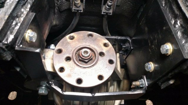

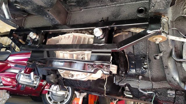

MrPhotographer06 Posted February 26, 2016 Author Share Posted February 26, 2016 Here the 8.8 mount. No front mount yet, but seems like it'll work...not sure how I feel about it yet, but I figure 4 good welds on each side of the mounting surface to the mustache bar mounts are better than 4 bolts... Maybe. Quote Link to comment Share on other sites More sharing options...
1969honda Posted February 26, 2016 Share Posted February 26, 2016 Looks stout, what wall thickness tubing are you using? Quote Link to comment Share on other sites More sharing options...
Richard Oben Posted February 26, 2016 Share Posted February 26, 2016 Nice job on the mount. My 8.8 is only on the M bar. Hope it works LOL. R Quote Link to comment Share on other sites More sharing options...
MrPhotographer06 Posted February 26, 2016 Author Share Posted February 26, 2016 Not mine, but the one I'm building. I will get metal specs this weekend and share. I really like that it's one piece. Quote Link to comment Share on other sites More sharing options...
MrPhotographer06 Posted February 27, 2016 Author Share Posted February 27, 2016 "The tube for the mustache bar is made of 1" square tubing 1/8th thickness. For the front mount, two 1/4" plates were welded to the car where the stock front mount was located (the red arrows in the pics point it out). Then another 1/4" thick plate was bolted on so the diff mount can be removed. " Quote Link to comment Share on other sites More sharing options...
MrPhotographer06 Posted February 27, 2016 Author Share Posted February 27, 2016 Not sure how I feel about this mount lol Quote Link to comment Share on other sites More sharing options...
