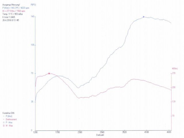

munters Posted June 2, 2016 Author Share Posted June 2, 2016 Ok finally I passed. I did change the Jets, retarded the Ignition and especially put a Air Box with a hose connected to the smaller radiator support hole (just 2") The mix of that brought me to 170hp and the rest I blocked the max throttle (underneat a piece of carpet nicely hidden) Attached is the final Dyno Value up to 4680 rpm because it stayed there up to 7000. Original was 120 DIN Hp and they accepted the 140 HP (+20% max. is allowed). The Brakes I changed as well back to Drum. The noise was also a good thing, because the measurements are taken at 80% of the max HP RPM value (in my case 80% of 4020rpm = 3216rpm) I passed at 74dB (max 74). Quote Link to comment Share on other sites More sharing options...
