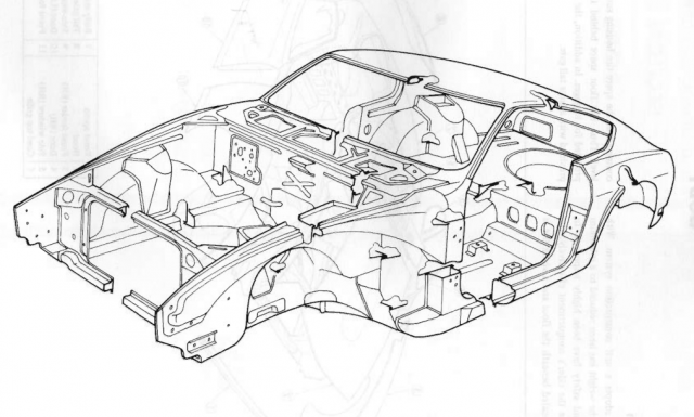

~KnuckleDuster~ Posted July 3, 2016 Author Share Posted July 3, 2016 (edited) Ok here's the nasty. Looks like jack abuse directly to the floor to me. I can't find much evidence of previous accidents, just this beat up floor and frame rails. and strut tower tops for those interested Edited July 3, 2016 by ~KnuckleDuster~ Quote Link to comment Share on other sites More sharing options...
MaritimeRiceburn Posted July 3, 2016 Share Posted July 3, 2016 Floorboard twisting at that level is definitely not a good sign. A 1/4" dent in my firewall area floor pan was enough to set my car off in the front end. Check the alignment of the headlight bucket, turn signal housing and the hood/fender. If they seem to be out of alignment that's a good indicati on of a frame issue. Unfortunately with the way these cars are designed the strut tower won't give you an indication of a collision, as the majority of the bend should occur in the firewall area of the frame rail, just after or before the taper. Quote Link to comment Share on other sites More sharing options...

Chris Duncan Posted July 3, 2016 Share Posted July 3, 2016 (edited) Best guess is your upper strut mounts are not straight. The easiest way to check short of paying a frame shop would be with a Bosch laser level. About $100. You could get away with a string level but it's very tedious/ time consuming and not as accurate. First level the car using probably the jack points, then check the level (height) of the A and D points in this chassis spec sheet. You don't need to get an exact measurement like the diagram you are just comparing right to left to see if it's level. To level the jack points you would set the laser up underneath and measure upwards. To level / measure the upper A, D strut points you would measure down from above with the laser projecting from a ladder or similar item. The other suspect area would be the struts although you say it was like that before with different struts on all four corners? The different front springs is a pretty good sign it was like that before. Edited July 3, 2016 by Chris Duncan Quote Link to comment Share on other sites More sharing options...
MaritimeRiceburn Posted July 3, 2016 Share Posted July 3, 2016 I'd personally suggest using the datem (?) Points on the cowl and rockers. You can stick a pencil in them and get a close enough measurement. The chassis has something crazy like 4mm tolerances Quote Link to comment Share on other sites More sharing options...

RebekahsZ Posted July 4, 2016 Share Posted July 4, 2016 Would you consider leveling the car with the coilovers, then put the car in a good level concrete garage floor and measure around from "pick up point" to point with a tape measure? The pick up points are basically for the front: the TC boxes (there's a bolt in the center), the inner LCA pivots (there's a bolt in the center) and the bottom facing of the study tower. For the rear: the front and back center LCA mounts, and the bottom face of the strut tower. Before you submit yourself to a frame puller, measure that stuff yourself. The floors really don't affect alignment-they can be bashed to hell and the car can still be square. If you have struts mod-ed for Tokicos, you should be running springs in the rear that are 2" longer than in the front. And with Tokicos, the front springs typically are loose (an inch or more) if the car is jacked up. My spare chassis has had the shit smashed out of it and it still sits level. I'm sorry you are having trouble. Quote Link to comment Share on other sites More sharing options...
