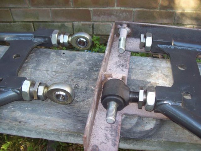

Chickenman Posted July 13, 2016 Share Posted July 13, 2016 On 7/13/2016 at 2:34 AM, NewZed said: It's been noted over the years by several, how the bushings allow the rear wheels to move forward in the wheel well. As the LCA bushings compress. There's pictures out there. Many people have problems when they install a short nose diff behind a high torque engine. There are threads out there about the Q45 diff, and the short nose R200. Maybe the R230 also. Leverage is the key. The shorter the lever arm, the harder it is for the mount to hold it down. True... but he's running aftermarket LCA's which should have come with Poly bushings on the Inner pivots. The outers are Heim joints. . And as the inner LCA Poly bushings are fairly small, they shouldn't flex that much??? Quote Link to comment Share on other sites More sharing options...

Boy from Oz Posted July 14, 2016 Author Share Posted July 14, 2016 (edited) Firstly let me offer my genuine thanks to all who have contributed to this thread, some really useful input. Constructive criticism never hurt anyone. I think I really need to film the front of the diff to try and establish a fuller picture before making changes, if any. A bit more information: 1. The inner bushes on the LCA are OEM rubber - some may have missed that earlier. (See point 4) 2. The outer ends are 'bushed rod ends', replacing the metal spherical rod ends. (See point 4) 3. Despite the LS1 the car is for touring and not for performance use - driver is too old, too slow, and too stupid! 4. My major initial concern was related to metal fatigue. I'm happier to see energy dissipated in bushings, and accept the associated suspension geometry change, rather that through the S30 shell and OEM or fabricated mounts, etc. Sorry if I'm reinventing the wheel here but I haven't followed too closely other non-standard diff installs. Again, my thanks for the input. Edited July 14, 2016 by Boy from Oz Quote Link to comment Share on other sites More sharing options...
