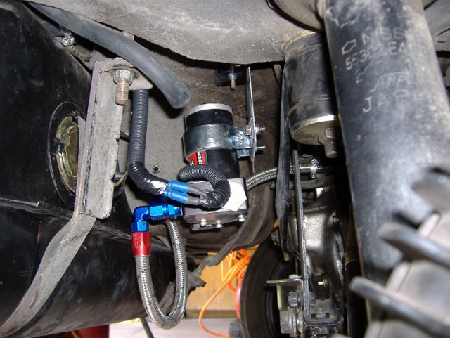

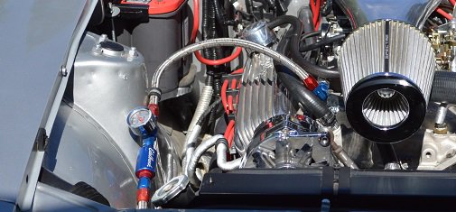

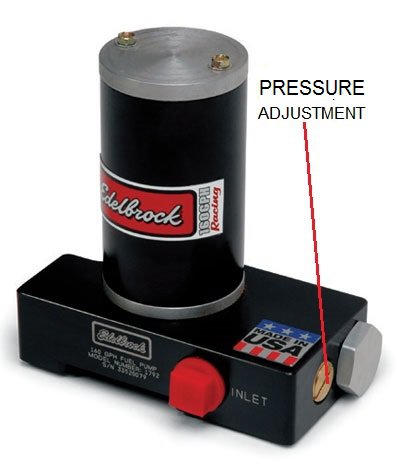

Miles Posted August 14, 2016 Share Posted August 14, 2016 (edited) This is the fuel pump I use with a SBC 350. Installed it seven years ago. No problems. Output pressure is adjustable. Not much noise. Be sure to install a fuel pressure gauge. https://www.summitracing.com/parts/edl-1791 ":The JTR manual says to mount near the gas tank" Correct. Fuel pumps push better than they suck. Be sure to search the fuel forum for more information about which fuel pump to use as the topic has been discussed many many times. Edited August 14, 2016 by Miles Quote Link to comment Share on other sites More sharing options...
