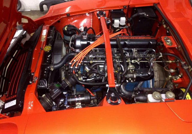

I'm planning on installing an inline fuel pressure gauge in the engine compartment of my stock EFI 1978 280Z. I would appreciate suggestions as to where to locate it (outgoing line from the fuel filter, in the fuel rails prior to the regulator, etc.). Where have other members placed their fuel pressure gauges? Any help (especially pics) would be appreciated as always.

The two red things don't go together.
