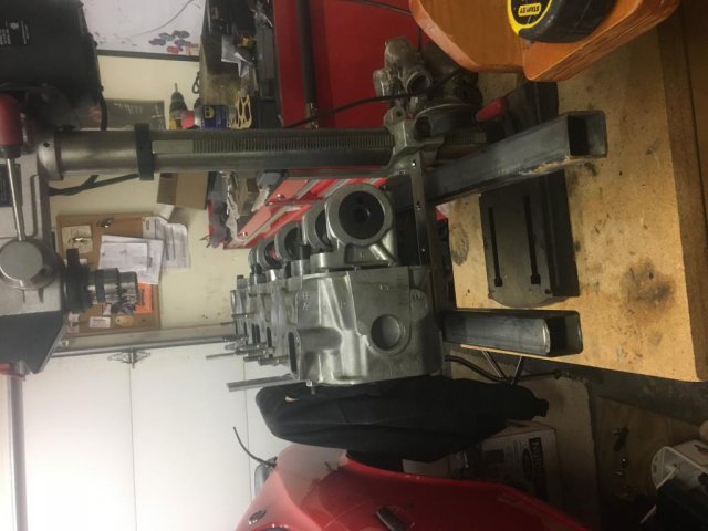

madkaw Posted April 11, 2017 Author Share Posted April 11, 2017 Drilling the head at home was a bit of a challenge . I think I got'er done though. Notched for injectors and a fresh cut on the head and I should be in business Quote Link to comment Share on other sites More sharing options...

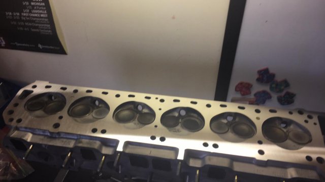

madkaw Posted April 15, 2017 Author Share Posted April 15, 2017 Head is back from the machinist with a fresh cut. CC the head and came up with 37cc , so I should be around 10.5:1 now . Need to finish cleaning up things and putting some new stem seals on. Quote Link to comment Share on other sites More sharing options...

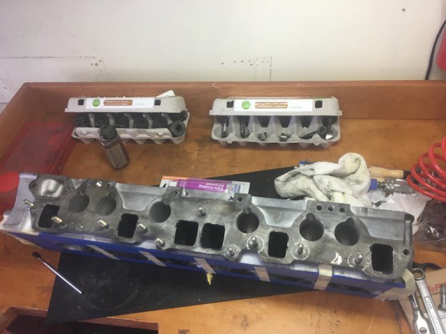

madkaw Posted April 22, 2017 Author Share Posted April 22, 2017 Intake ports notched for injectors . Little wider than stock, but within limits of the gasket . Drilled holes are tapped . Got my seals back in and a quick valve lap and installed valves back in head. Quote Link to comment Share on other sites More sharing options...

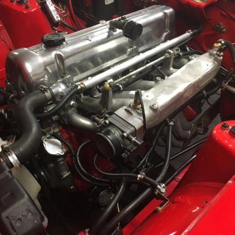

madkaw Posted July 1, 2017 Author Share Posted July 1, 2017 (edited) Sorry I let this thread for dead, but swap is complete . A lot of things could have gone wrong here but somehow the L gods were good to me and it all came together. The N42 bolted up , but I worried about the lack of support for the inner runners 3&4 where they bolt to the head. I've had no vacuum leaks so it must have seated well enough. Ive shaved off .050+ off this head , no shins. I dropped the cam (towers and all) from the top of my workbench, No leaks - no real issues , just fun tuning - on a laptop!! The driving experience is a bit different . The Mikunis seem to hit harder during WOT , but the EFI is right there - it comes on a little less linear as far as power. No raw fuel smells !!! Quiet in tank fuel pump!! Tuning is much more fun and a lot less work . No looking back for me. Need to get to the dyno and see how the numbers look. Edited July 2, 2017 by madkaw Quote Link to comment Share on other sites More sharing options...
