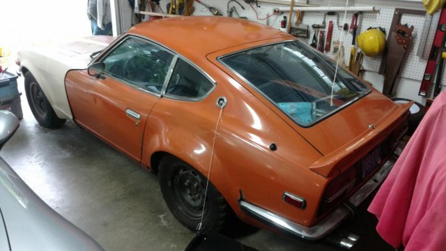

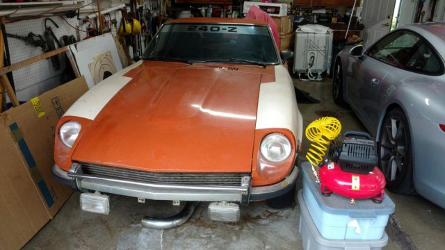

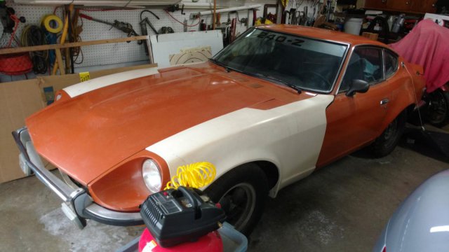

dfknoll Posted January 16, 2017 Author Share Posted January 16, 2017 Here she is. Like I said, the current owner is a wealth of knowledge. He is the original owner and said he remembers having Datsun factory reps coming out to their club meetings and having them show the guys how to work on the cars and how to do performance modification and stuff like that. I am really excited to dig in to this thing. It will probably take me at least a couple of years to finish it up, but I want to do it right the first time. Don't like doing anything half ass. Quote Link to comment Share on other sites More sharing options...
