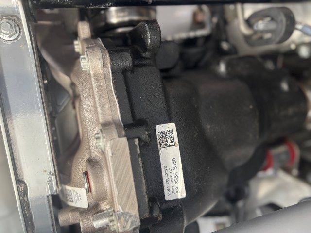

Bottom View of 2024Ford Motorsport Super Duty 8.8 Differential with Torsen Limited Slip with 3.55 Gears.
Right Side View of the Differential -note the Huge Axle Shaft capable of handling 800+ HP!!
