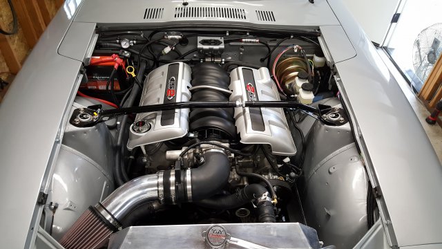

mrk3cobra Posted December 10, 2018 Author Share Posted December 10, 2018 This weekend was the 1st real test for the LS2. I ran the engine for around 1 hour. The exhaust sounds great. The only problem I had was a small fuel leak at the carter low pressure fuel pump that feeds the Edlebrock sump located at the battery tray. The other problem was the LS2 thermostat was not opening until 215 degrees. The second fan was coming on at 217 degrees the engine would idle at a constant 217 degrees. I pulled the thermostat and put in boiling water and it opened at 215 degrees. The thermostat says 86 C looks like it is no good. I ordered a new delco 187 degree thermostat. My primary fan was coming on at 210 degrees, I will modify the ECU to come on at 200 degrees. Below is some pictures, the paint is about 60% complete. The color is the original metallic silver from 1971. The vintage air HVAC heater worked great. Quote Link to comment Share on other sites More sharing options...

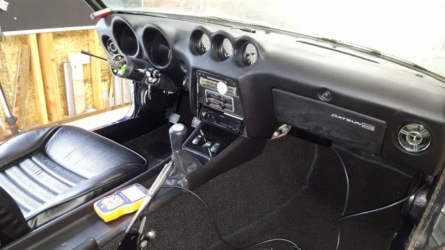

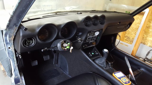

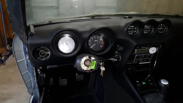

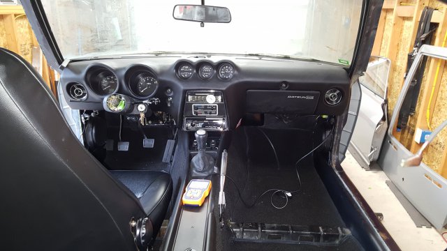

mrk3cobra Posted December 10, 2018 Author Share Posted December 10, 2018 Here are some interior pictures. Just waiting for my new steering wheel from thezstore.com to complete interior. Quote Link to comment Share on other sites More sharing options...

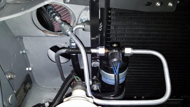

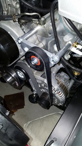

mrk3cobra Posted December 18, 2018 Author Share Posted December 18, 2018 Finished running the AC lines. I ran the two lines to the evaporator through the passenger inner fender. I removed the lower passenger vent. I evacuated the system all went great. Next I will charged the system when the weather warms. I also replaced the gutted power steering pump and replace with a cleaner bracket and pulley from ICTbillet.com Quote Link to comment Share on other sites More sharing options...

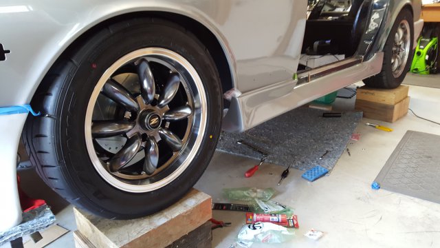

mrk3cobra Posted December 19, 2018 Author Share Posted December 19, 2018 wheels and tires installed. Quote Link to comment Share on other sites More sharing options...

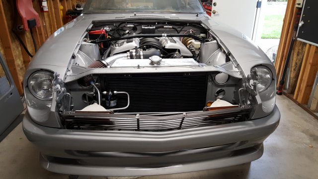

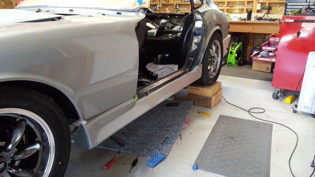

mrk3cobra Posted February 17, 2020 Author Share Posted February 17, 2020 (edited) Today was a milestone, I drove the car for the first time around the block. Front and rear sway bars installed, alignment done. Brakes felt a little soft, car has tons of power. Would like to install power steering in the future. I do not like the angle of the outer front tie rods. Will need to find some adjustable tie rods. The car is 90% done, need to finish blocking the roof and rear quarters. Edited May 16, 2021 by mrk3cobra update Quote Link to comment Share on other sites More sharing options...
