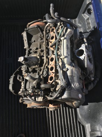

M_Dragan Posted December 5, 2017 Share Posted December 5, 2017 On black friday I picked up a vvti 2jzge out of a 98 GS300 for $50. Perfect candidate for my na-t build. Although, it didn't have the throttle body with it when I bought it. I was searching around for a replacement throttle body and I've seen a couple different options. Would the throttle body listed below work for a +/- 400-500hp build range? It's $80 cheap, all the rest of them are about $150-200. Throttle body I'm considering: https://www.ebay.com/itm/90mm-Reverse-Throttle-Body-With-TPS-Sensor-For-Toyota-Supra-1JZ-2JZ-Black/222249823126?ssPageName=STRK%3AMEBIDX%3AIT&_trksid=p2055119.m1438.l2649 Quote Link to comment Share on other sites More sharing options...
