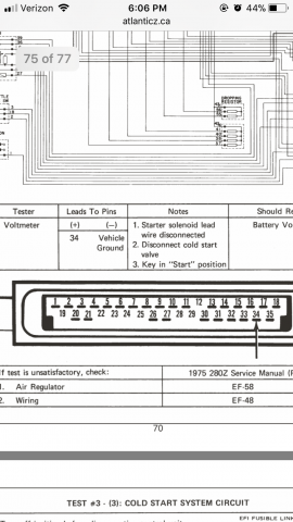

76 280z.  Went through all the steps in the FI BIBLE.
everything checks out until I get to here . 791CDD9A-8770-4E38-B59B-C2808EE5B9FB.thumb.png.9a2d4c50b8283a4ce79e8aa123dee961.png
Which is weird. I checked wiring and then also manually checked he air regulator and it’s firing the fuel pump and the injectors as it should.  I moved on with my steps and everything. Checked out leading me to a bad ecu.    Several days ago I the car was trying to start and backfiring.   Now I have nothing but a cranking engine.
I have fuel and spark.  I  tested the power relays for a click and they do that as well (one of them).
please help

Here's a simple test that you can do to test the injector opening circuitry of the ECU, and the wring harness.  It's been described by a few people over the years and you can figure it out from the first few pages of the Engine Fuel chapter.
Take a jumper wire and attach one end to the negative terminal of the coil.  Let the other end hang free.  Turn the key on, so that the coil has power and the EFI relay is energized, and tap the loose end of the jumper wire to a good ground.  This will cause the coil to spark.  Every third tap should cause all six injectors to open.  If you get the injectors opening then you'll know that, at least, the required circuit is intact.  It won't tell you how long the injectors stay open but it's a simple confirmation.  If you get coil spark but no injectors opening then you have a problem, that you can focus on.
You still seem to be looking at things that are easy to reach instead of the things that might matter.  But, you'll know a lot more when you're done, either way.  Good luck, have fun.

Confirmed that test  last night with the neg coil and the ground test.   The injectors indeed where firing.  I just wasn’t sure if that confirmed that they were getting the pulse while actually trying to start under normal conditions
Also rang out all 6 injectors terminals on ecu connector and they are were getting voltage.   I know I have fuel, I know I have spark and I know I have air  and she doesn’t even sputter or try to start.
